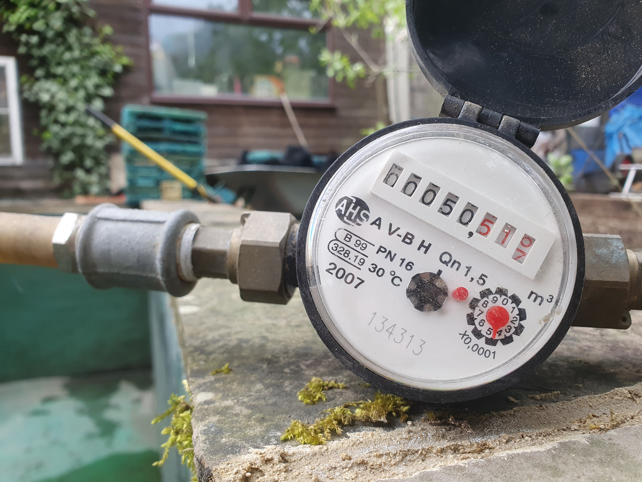

I started the first fill, its always good to know how much water it holds just incase you need to medicate.

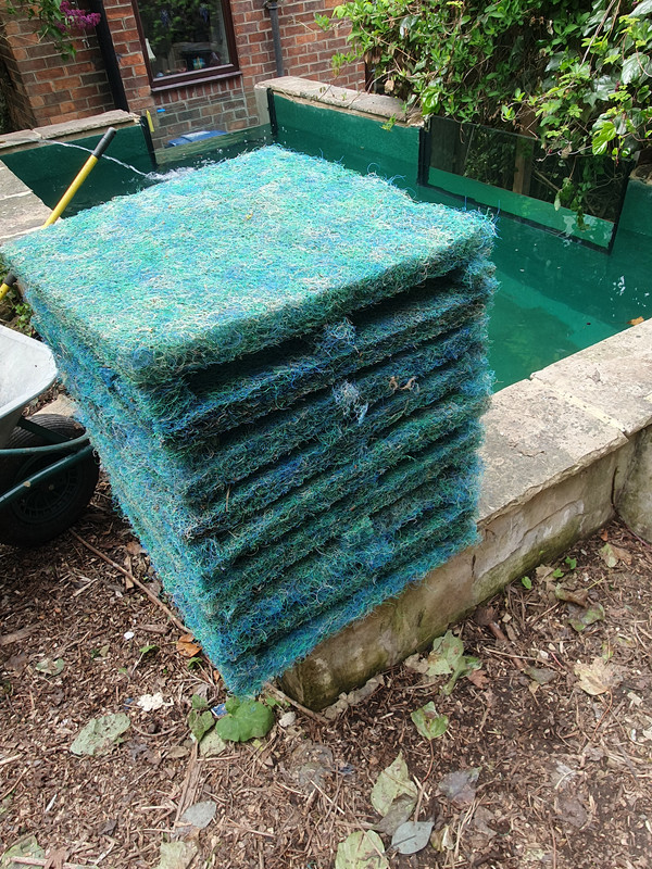

I rescued all the jap matting, lots of pressure washing, theres probably £200 so worth the effort. It will be getting disinfected later.

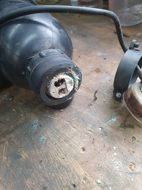

The uv lamp was toast, being sat in the bushes for years will do that. Luckily only a new tube and clean is all that it needed.

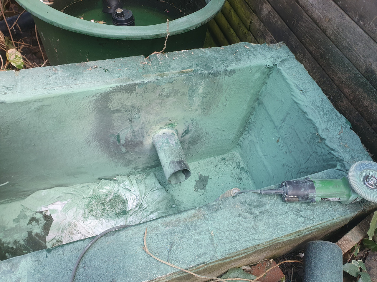

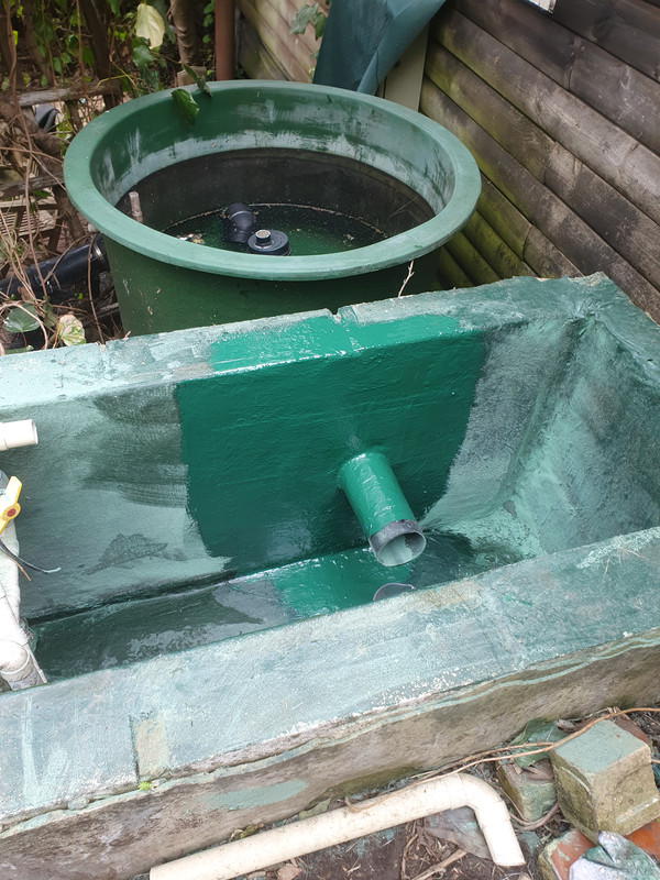

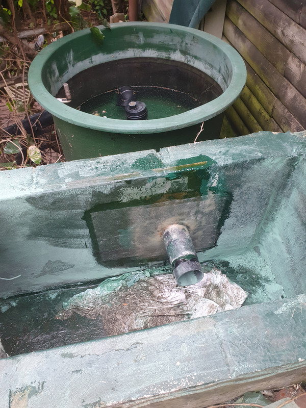

I filled the pond up and the it holds 10,300lts including the filters. It was quite nerve racking when it came to the windows. I found a leak on the filter chamber so had to re fibre glass around the inlet.
Ian, Japanese matting filters the water (which the Koi poop in obviously) and when mature the matting holds healthy bacteria that conditions and clarifies the water dealing with nitrates and nitrites etc. The lamp kills green algae, which does not harm the fish but makes them hard to see and will collect on the windows and walls. The alternative to Japanese matting (or addition in a separate chamber) is K1 - which are a kind of hollow plastic bead, usually agitated with oxygen pumped into the filter tank (as well as into the pond directly). The water has to be matured by adding fish gradually, so that the filters build up capability over a few weeks. Tested with special test kits to ensure Ph is in a safe range. The water has to be partially changed regularly and residues cleaned out of the filters with conditioned water. Water is usually run through a carbon filter to gas it off before new water goes in the pond.
This method of filtering is an old school one, most modern koi keepers will use K1 as Adrian mentions usually in modern filters called nexus. I did think about changing but the breeders in japan still use this stuff so it cant be that bad.
The big vortex thing behind removes any solids from the water, they fall out of suspension as they travel around. Sometimes filter brushes are used to trap detritus. The jap matting is the main home for the bacterial side of filtration, Ideally you dont want it clogging with poop as it will mess the process up.
We had Jap matting in our first Koi pond at the farm 25 years ago. Multi stage filter quite remote from the Koi pond. Can't recall if we had an air pump. These days as Wallace says, in a different place, we use a Nexus with K1. Keeping Koi if you want show or very large specimens is a bit of a pain actually. We also have Koi fry in what we call "the canal", green tench and sticklebacks etc in the nature pond, and Golden and Blue Orfe which I was told would not breed - but they have multiplied like mad in a much larger and deeper pond that has some flow and is aerated.
