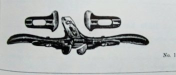

As well as Andy's suggestion, if you can find a router like this, it should be ideal. Preston made them but this one is unmarked.
They were a metal version of a similar wooden tool.
I'm curious about the fences. Clearly, you only use one fence at a time, and you put that one fence on whichever side it is needed. The thing I am curious about, though, is why one fence can only abut the cutter, and the other one extends over it as needed. I can't think of any circumstance where you'd need the left hand fence (from the lower photo) in preference to the RH fence...given that the RH fence can also be set at the very edge of the iron. Can anyone enlighten me?
I can see this being a tool which requires quite some skill to use, and maybe even a scratched groove first, to set the line of the edge of the rebate.
If you are making a plain edged semicircle from a single flat board, you'll need to cut 'downhill' (with the grain) at each end. You could do this by flipping a symmetrical tool (such as a spokeshave) over.
But if you are using the fence on a router like this one to define a rebate, when you flip the tool, the fence will be on the wrong side.
The answer is to have two adjustable fences. Each can be set back from the blade by the same amount. Then the tool is reversible without disturbing the setting.
The tool in my photo is not set up for anything in particular.
If it's a board you're working on, you'd have to remove the inboard fence when you flip the tool over. If it's a curved glazing bar, or something similar, then yes, there might be a circumstance in which the un-used inboard fence isn't in the way.
There's also the question of why the fences aren't identical.
I'm imagining that you are working on the edge of the board, so there's space either side.
But that's a good point about the fences. It looks like one is for a rebate on the near edge, but the other would work on the far edge.
Andy may be unaware the it should have two stepped fences.
EDIT to say two of each of those fences present....
What! I've been sold a pup... a veritable mongrel!
(Actually it was given to me, from a distant family member's tool collection. He would have used it in the 40s or 50s probably.)
Perhaps you have just given me an excuse for not having made any curved sashes!
No, no, no.....you don't get away with it that easily! You only need one fence at a time......so you'll just have to take it off and swap to the other side when you work on the other "hand".
Oh, hadn't realised this, it had two pairs of fences.
One pair for rabbeting and one pair for moving fillister work.
I agree! (But I should have looked 🙁)
I wonder if I missed the vital bits in my ignorance... But it was probably 30 years ago...
