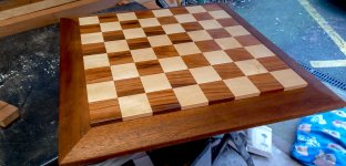

Over the weekend I used my new Dowelmax jig for the first time.
Absolutely brilliant bit of kit.
I've always shied away from dowels - accuracy was more luck than judgement, and using more than two dowels in one run meant I'd normally end up re-drilling holes oversize.
This jig makes things so easy it almost feels like I'm cheating :D

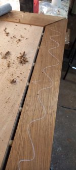

This has just been wiped with white sprit to show the grain - the board isn't fixed down yet.
