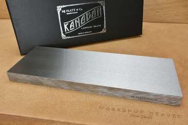

With a new 120g belt installed it was only a couple of light passes (with some cold water dunking inc) to remove the last of the chip. I thought I might have to do some work with the 'Kanaban' lapping plate and some coarse valve grinding paste (!!) to shift the 'ura' (the depression in the back) down a smidge but didn't really need to:
...as there was still about a mm between the edge and ura.
