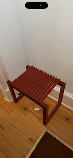

I drew up a model in CAD and exported it to my Phone to get an augmented reality shot to see how it would work before proceeding.
Started with the top , routing out as close as I dared to the lines and finishing with hand tools, then the legs were mitred.
A dry fit assembly placed where the AR model had been to check reality matched what the phone projected.
