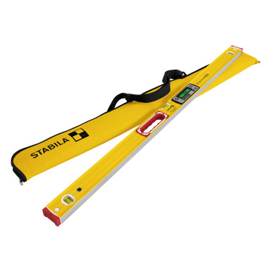

Easy way to check a level is to rotate 180 degree's and it should show the same bubble position. The Stabilla ranges with milled edges are a good level, the 86 range with rubber endcaps is great but not if you are laying bricks . If you want better precision, often to precise then look at the Stabilla digital
If the underside of the level is concave then it will still seem to be good with that test, but it won't be straight. As written above, put 3 different ones against each other in both orientations and check if there is light. If there isn't, they are good. Theoretically there still is a chance of distortion that you wouldn't notice with that test, but that chance is exceedingly small.
