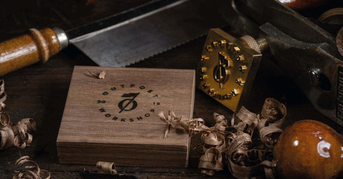

I had a branding iron made with my monogram (you may have seen it on some of my turnings). I went for the electric version. I find slightly wetting the object’s surface and a few practices to get the pressure and time right helps.
I didn't even realise electric ones were a thing. I've got three of them, two brass ones (a big one & a small one) and a hardened steel punch (for metalwork projects). I'll post some photos here soon. I have managed some successful "brands", but I'm quite hit-and-miss at the mo.

I said I would talk a little about branding...
These are the branding irons I bought:
The two brass ones (which will be getting new handles at some point) are for branding wood. The one at the top is hardened steel and with a simplified pattern (just sharp lines following the outline: without the varying line width). It's intended to be used for punching into metal. I haven't managed a successful punch with it yet, but I've got a few ideas of things that might help.
These were my first few attempts at branding with the brass logo stamps:
Wetting the wood definitely helps, but it's also important to get the temperature right, something I haven't mastered yet (I may at some point follow @AndyP's advice and get an electric heater for them, but I'd like to persevere a little before resorting to technology). At the moment, I think the most important thing is to make sure I've got a bit of scrap wood to practise on before attacking something important!
This is the first mark I've done (with the smaller stamp) on a finished project:
I made that mark before assembling the box (just in case I had to scrap it and make a new box base!)
I've also used the stamps on cork. The smaller one really didn't work as a hot stamp on cork. The big one worked okay though:
The little one can be made to work, but using it as an ink stamp rather than a hot stamp:
Again it took a bit of practice to get that right, but I think the result is okay.
I definitely need more practice (especially with the hardened steel punch), but it'll be fun to play with them.
