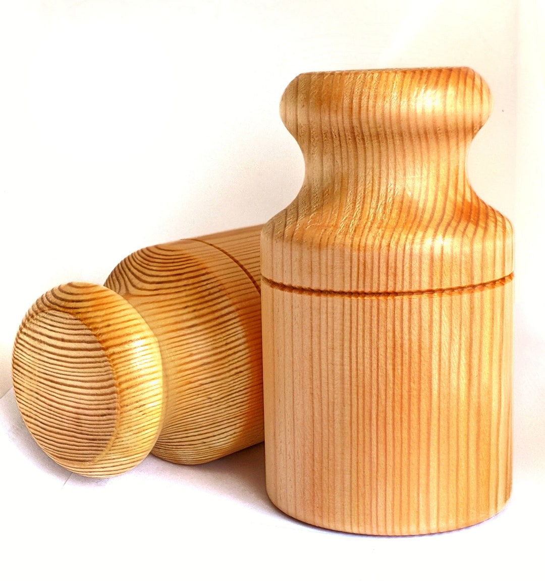

I would like a 1/2lb, 1lb and 2lb pork pie raiser in beech or some food safe hardwood.
Does anyone happen to know the correct dimensions for these (or even have any that you don't want)? I've struggled with a google search. I think they are often called a pork pie dolly.
I have a lathe of course, but am not the greatest turner as I don't do much. Looks pretty simple though.

Nope. Saw that, they only give one size and they are sold out. Everywhere doing ones not made of softwood is sold out. But thanks anyway.
Thanks for the photo. I need to do fairly accurate measurements to get the correct pie weight. Maybe I'll just turn a few to experiment. We will be selling the pies (not many - maybe 30 a week for a short period) so to comply with regs I need a degree of accuracy.
Yes, HOJ. It's just a former really. Traditionally wood but plastic would be fine. If I had a 3d printer...
This seems to give the measurement for a 1lb pie Adrian …
Not sure what level of accuracy you need but I’d have thought the recipe used would have an impact on the final weight?
Thanks Robert. Accuracy is not super critical as long as the weight is at or slightly over the declared weight. I don't have to do many (40 or so I suspect) but it is for a TV thing so needs to be reasonably authentic. Having checked again they have asked for wooden dolly moulds. Commercial ones use metal moulds.

I asked Copilot. Bear in mind it makes mistakes...
To make traditional British pork pie dollies for different pie sizes, here are the typical base diameters you'd want:
Pie SizeDolly Diameter (approx.)
½ lb60 mm
1 lb72 mm
2 lb90 mm
These measurements are based on handcrafted dollies used in Melton Mowbray, the spiritual home of the pork pie. The dolly helps shape the pastry case by hand-raising it around the wooden form, so the diameter is key to getting the right proportions.

Thanks for the dimensions btw Steve. I will follow that. Failed to find it myself. Super helpful.

Interesting that in the Etsy link I posted yesterday a maker of Melton Mowbray Pies is selling them with a 90mm diameter described as “The perfect size and shape to make a traditional 1lb (454g) Melton Mowbray Pork Pie …” AI 🤷😉
Conveniently enough, my pair that I've not used in many years came out of a moving box a day or two ago. They're 72mm diameter, approximately 90mm high to the top of the straight section, and I think - though it was a while ago - the 2lb of meat that I made would do two of them if made up quite tall, or three if I did them to what I thought was a more aesthetic ratio. Don't hold me to that part, but 72x90mm is definitely a size that someone was selling around 15-20 years ago.
