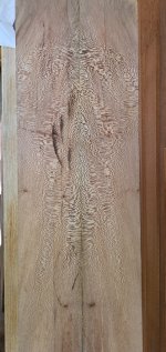

The first cut was at about 1"/26mm taken slowly with the Ash first... 4 cuts by up ending and turning the block and running through... Then increase to about 1½"/38mm... cut/turn/up end. With the Ash I left about ¼"/6mm to cut with my handsaw. I was disappointed but expected that the damage by the woodworm would be too much. So the Ash is for the recycling centre wood container.
The London Plane was much better. Same method as with the Ash. Took off the two 'sides' and then evenly divided the remaining amount to get three more slices - 5 in total. Did the same with the oak - 5 pieces. They are now waiting to be put through the thicknesser in a couple of days time - I've an appointment at the RUH eye clinic in Bath tomorrow at 1.30pm...
I've some cedar - approximately 4ft long by 4" square so that I'll try on the bandsaw - feel I lost too much with the blade on the tablesaw. I've also some Brazilian mahogany, about 4" × 2½" (need to measure to be definite) to put through.
The photo of the cutting is of the Oak. The London Plane is attempting to show 'book marking' of a couple of the boards... although some blade burn marks. In the 1st I've increased the 'Contrast' setting by 100% to try to show the grain more enhanced... the final is with no contrast adjustment.
