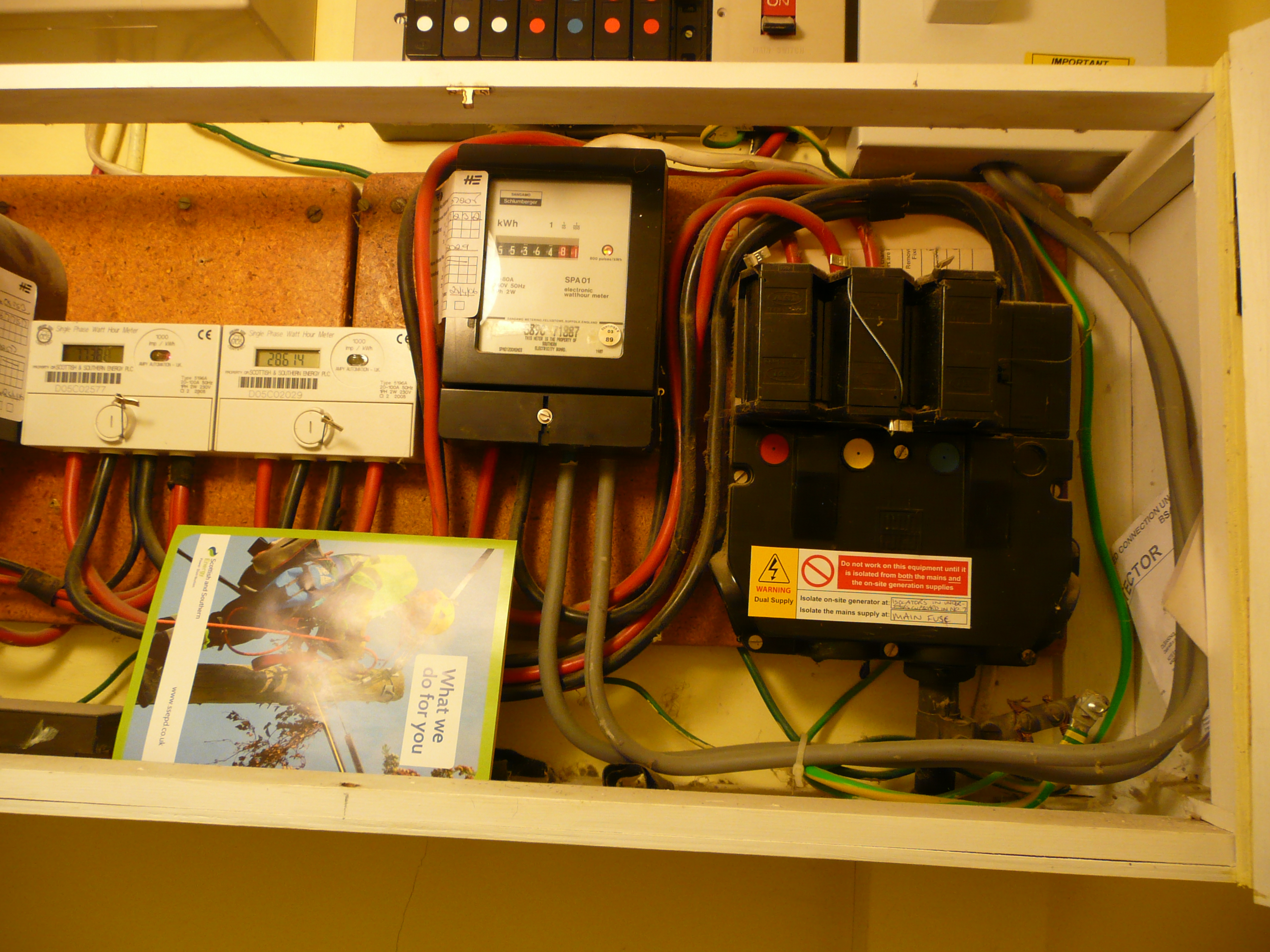

On a related subject it turns out that the mains supply to our property is (unusually) for the uk is 3 phase. Our property on one phase and the attached granny annex on a second phase - the shared/linked sun room has supplies from both phases (lighting on one phase and power sockets on another). I suppose ther is no simple (safe) way to run three phase motors using just two phases. I was unaware of the supply until the electrician mentioned it in passing way after having provided a single phase supply to my workshop!

Jeff, do you have two single phase meters on your supply or one three phase meter at the point of entry?
This will affect the range of possibilities.

misterfish":2ejf8b6b said:
One phase is connected to our supply and a second phase conneced to the granny annex supply (tis is an economy 7 type supply with two meters and a time switch. The 'blue' phase is not connected to anything
http://www.drosera.f2s.com/3phase.JPG shows the incoming supply.
Jeff
OK so you can't connect three phase kit simply.
Trying to do anything with just two phases might cause you to be billed twice - I think (?)
so single to 3 phase converters/inverters are the best options.
hth
Thanks Bob
That's what I thought - I think there's only a single phase armoured cable that goes to the workshop and on to the garage so any upgrade to a proper 3 phase supply would be awkward - not to mention actually getting a 3 phase meter fitted would no doubt be awkward and expensive. If I do acquire any three phase equipment I'll use a converter/inverter.
