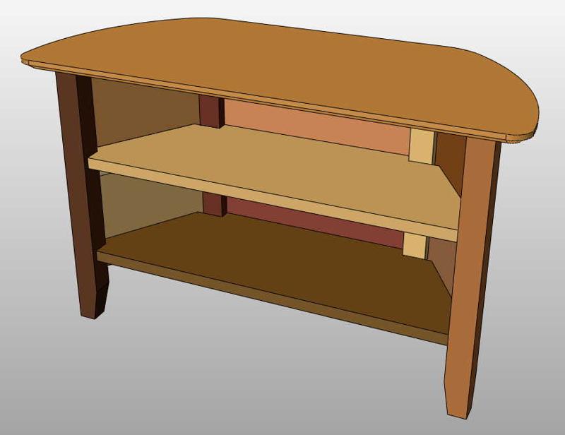

This is what my CAD model looks like so far. I'm sure it's going to change a lot before I start cutting wood (and I haven't even started modelling drawers etc), but you've got to start somewhere.
The colours are random to make it obvious where the different pieces of wood will join; in practice it will all be oak. I haven't started to think about that angled join on the sides (whether it needs any support) or anything in the way of rails for the shelves and top. Dimensions of this model are 820 mm × 340 mm × 500 mm as that seems a sensible outline size.

Corner units are great, but watch these couple of traps: A/ Don't take the structure all the way into the corner. Square off the back away from the corner, as you've done, because corners are never square.....but personally I'd take the top much further back so as to avoid the lost space where dog hair and spiders will collect.
B/ The long-grain junctions at 135 degrees need to be bang on, because they'll be the only thing you'll ever see if you don't get them right.
Thanks for the suggestions. It won't actually sit in the corner. It's a bit of an odd corner of the room if I'm honest: if you look very closely at the wall behind the left-hand-side of the TV, you can see that it goes very dark in the photo immediately behind the existing TV stand. That's because the bit of wall you can see on the left of the photo is a chimney breast and there's an alcove in the corner. High up in that alcove there are some shelves. The space at the bottom is largely dead space that we're just leaving as dead space (I don't want to do anything too involving as we're hoping to move sometime in the next couple of years). At the moment we're storing a table from my late father-in-law's house in the alcove under the shelves - you can see one of the legs of it if you look closely.
Yes, that's a good point. My previous drawing version had legs going down at that junction (which would hide the evidence a little!) but it looked a bit odd with 6 legs, so I got rid of them. I still don't feel like the design at present is quite right, but I haven't worked out what to do with it.

I think a subtle curve to the top and rounded corners would lift it from a mass produced corner unit.
Id also add a chamfered underside of the front edge for the same reason.
I've had a play around in the CAD and (assuming I'm understanding what you mean) I agree. Thanks for the suggestion.
Good point. Just the front edge? For now I've added it all the way round the top in the model. Whether I actually have the skill to make it that way remains to be seen :D

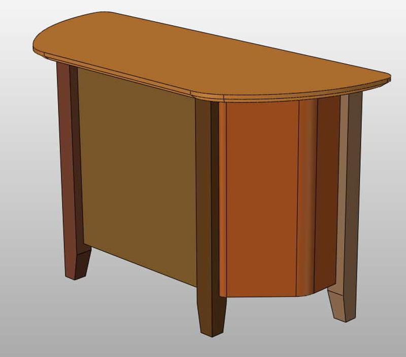

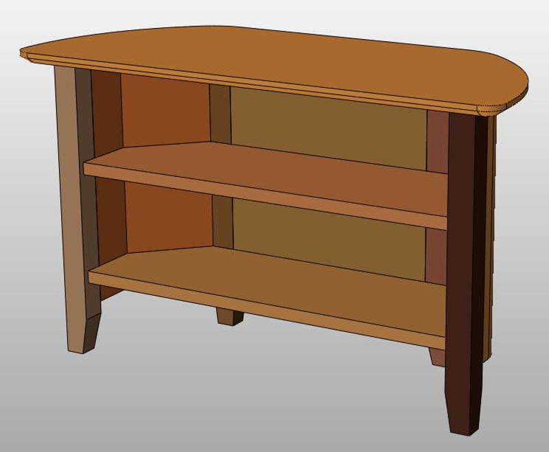

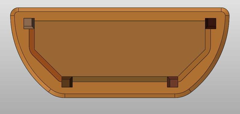

An updated version of the CAD model:
Changes:
  • Rounded top profile rather than 45° angles with fillets.
  • Chamfer under the top edge to make the top look a little lighter.
  • Added chamfer onto two sides of each of the bottom edges of the feet, to match the style of my side table.
  • Set the shelves 10 mm back from the front edge: with wood expansion/contraction, they're never going to be exactly in line, so it seems better to set them back.
  • Filleted (rounded) the side panel joins: this will have to be done by very carefully joining the two boards at just the right angle (and ensuring an accurate edge joint) and then rounding off the join, probably with lots of planing and a bit of sanding.

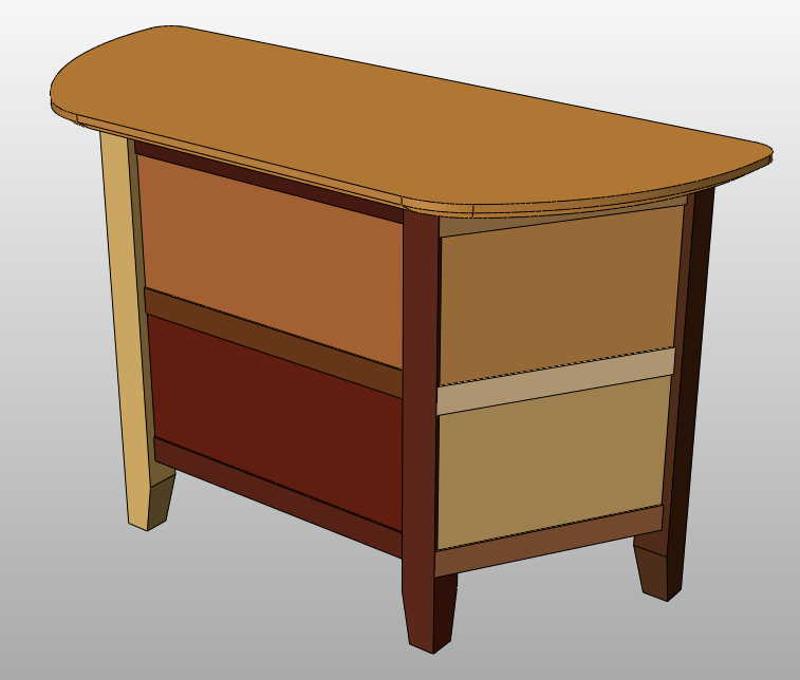

A few more views of the current version:

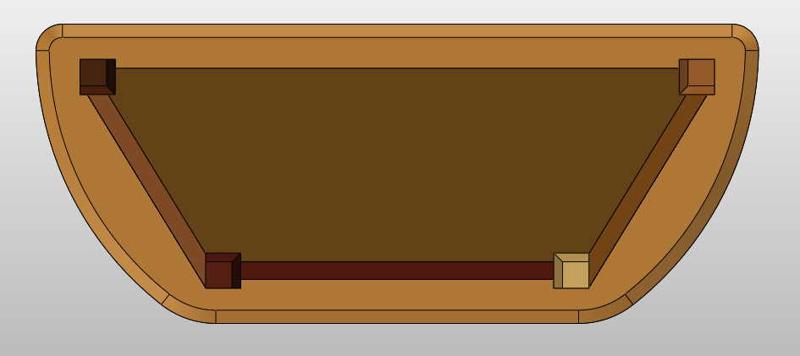

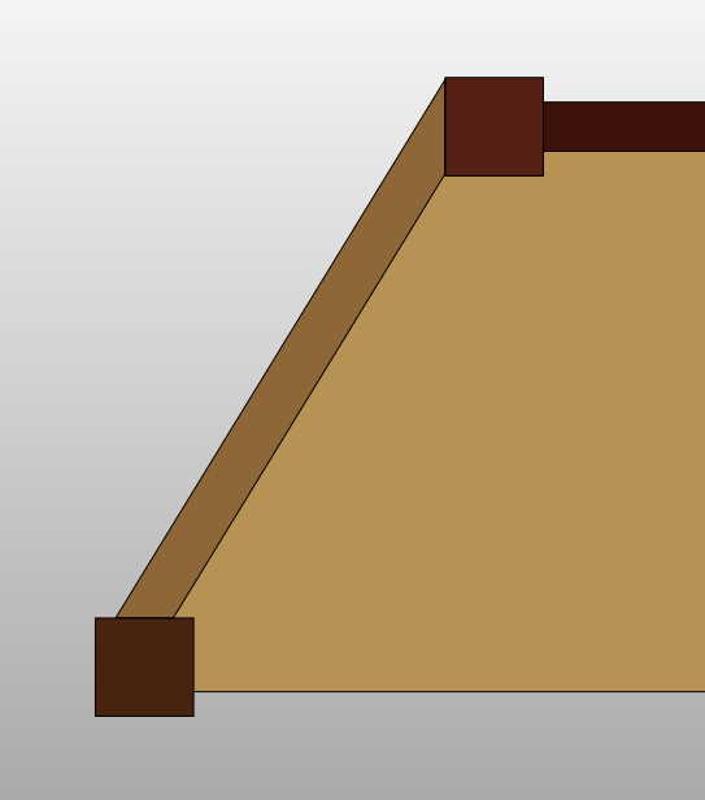

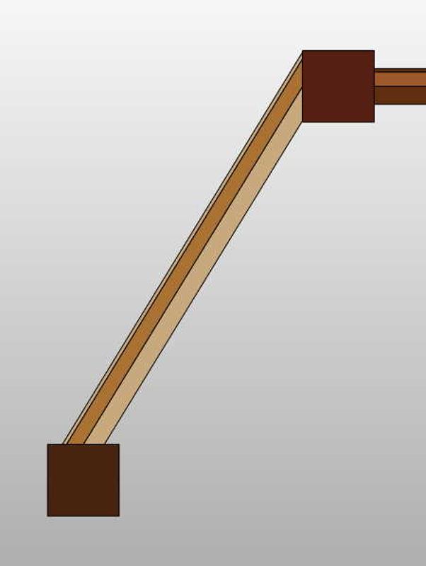

Next thing to think about is rails. These are for the shelves and the top to sit on and also to hold the legs square to one another. I need to decide whether they go outside the panels (and are hence on display) - probably not - or inside the panels. If inside the panels, do I move the panels outside (or at least flush with the outside of) the legs (they're currently flush with the inside of the legs) or do I make the rails sit inside the legs?
Alternatively, do I make the rails more of a feature: make them visible around the outside with the panels being shorter sections that go between the rails? All of this also depends on me figuring out what to do with the rails with respect to how they go round the corner in the side panels! One option is to make my life much simpler and make the side panels form a straight line between front and back legs (which might look okay now I've made the top have a curved profile rather than two straight lines). That latter option could make the drawer(s) look a bit odd when they're open though.
Here are a few views of what it might look like with segmented panels and straight rails:
I'm not convinced by this yet to be honest. The rails look a bit weird where they join the back legs (although I could improve this a lot by rotating the back legs by 30°) and to make the panels fit on the (currently 20 mm wide) rails and leave space for the shelves to sit, the panels are only 8 mm thick:
