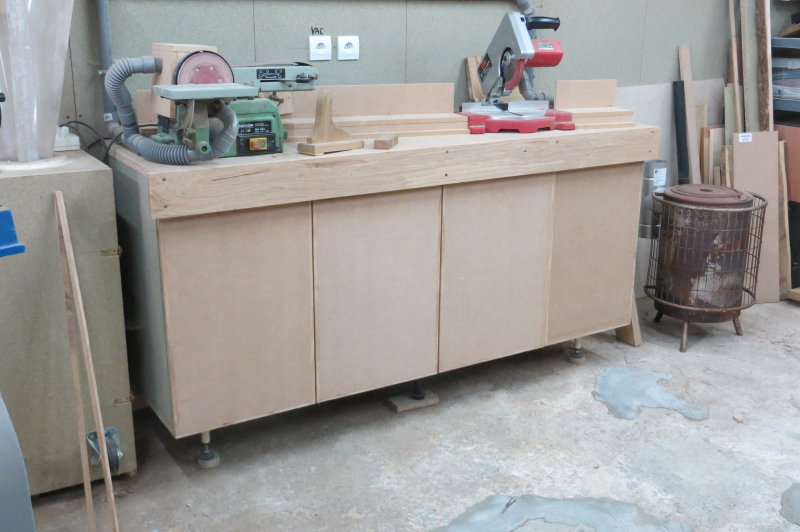

That's looking really tidy and I like your cupboards as well.
