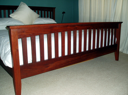

I've decided on a design, which is fairly simple, but should show off some decent wood a bit. It's based on a design by Derek Cohen, who I expect will be familiar to most of you. As far as I can see there's no detailed account of the build available online - just one photo in the section of his website headed
"A few images of past furniture builds". I'm sure he won't mind me linking to his photo of it:
His is king size, in jarrah. This one will be a standard double, as determined by our mattress and the space available. It certainly won't be in jarrah. I just like the unfussy construction, with the slight curve on the cross rail, the capping rail with its chamfers underneath and the tapered feet.
