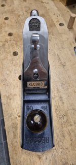

Over in the hand tools section, Rob (@Woodbloke) has been showing us his newly acquired Record 04 Stay Set plane.
Being a woodworker with higher standards than many, he immediately set about getting it into a fit state to remain in his workshop, with a complete clean, a new pair of handles and then a new iron. Along the way, he found that the replacement iron was actually thicker than first described, so there was a risk, helpfully pointed out by @Sheffield Tony, that the screw that holds it in place would be too short and so fail to engage properly with the frog. But where can one get a longer screw of the right thread and style of head?

First off, here's Rob's Record screw (centre) between a 1970s Stanley on the left and a 1920s one on the right, to show what I was aiming for. Neither of mine was an exact match, so it was worth getting the right one to copy.

So here's the finished item, side by side with the original. I left it full length so Rob could trim it to the exact length to suit his plane.
