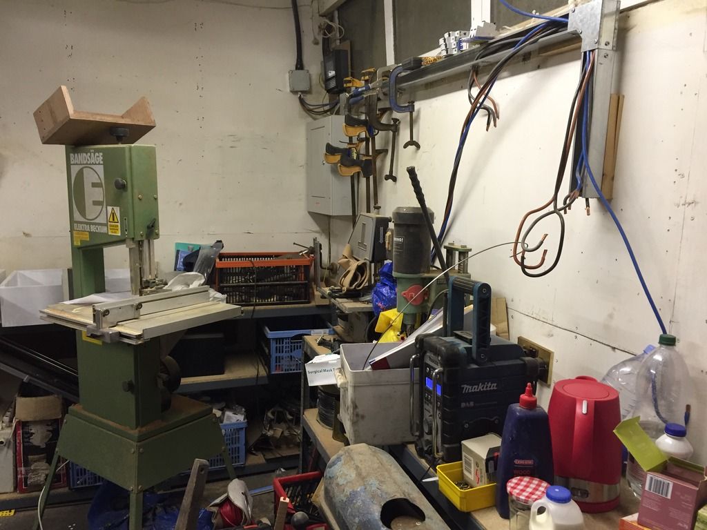

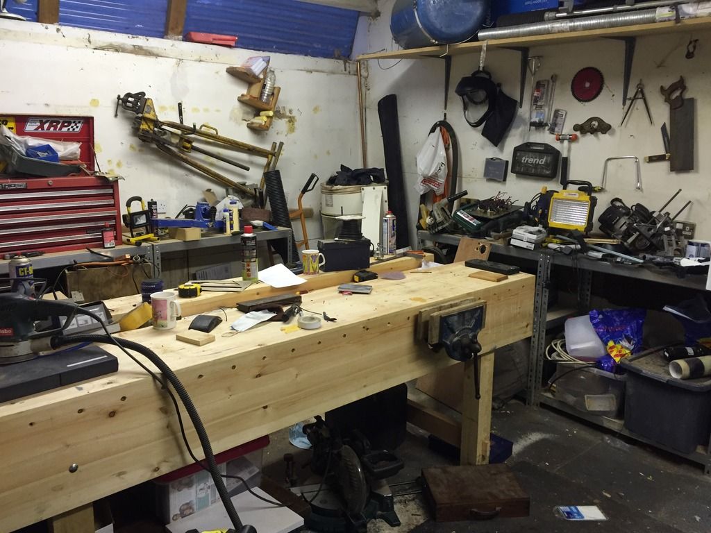

As you can see Tracerman, I've done a pretty good job in spiking glue and drips of paint on it.
Here is the other side of the workshop....it isn't usually quite such a tip but I have been helping a friend move house with my truck and things haven't yet found equilibrium again! I keep hoping the landlord might sort out his 16mm tails as they are irritating and might just get weighed in with the rest of the metal I have soon.
Gasp. I've just spotted a new space to store stuff. On top of the bandsaw :obscene-drinkingcheers:
It is a bench doing what is is supposed to. Thanks for the update and the workshop pics. Remember where there is work there is no order.

Nice sturdy looking bench.
