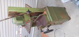

Multico plainer
this seems to be cast iorn and is very very heavy

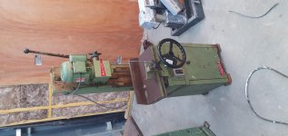

Multico morticer

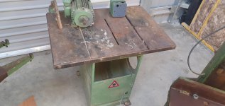

wadkin table saw
guys says the moto trips electrics

That's a cracking price for those, they shouldn't need too much TLC to get running sweetly. Multico stuff is actually rather nice and solid, they were considered a light trade machine back when they were made but compared to the stuff that Axminster sell now, the quality is far superior. I think that Wadkin saw is a Wadkin "Tradesman"? Not quite the same quality as their AGS saws but still very decent.
I bought a 12" Multico Planer for £400 in ropey condition, so your haul for £200 is a bargain!

Have a Multico planer,it's smaller than the one you have, only 9 " but it's a really good machine.
I think I paid around £180 for it.
A good clean up and sort out the table saw motor and you have three very useful machines.

That saw might need a 16 amp supply and nothing wrong with the motor, you should check the rating plate.

That is a great haul. I used to have the same morticer.
Did you get any bits for the morticer or the slot morticer on the planer?

The motor fault could well be simply a failed start or run capacitor. That would cause an MCB to trip.
Worse could be an RCD trip as that would be an insulation fault but thinking positiviely, that could be a deceased insect nesting in the wrong place.
