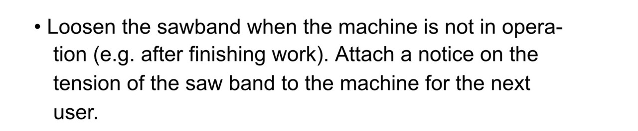

That’s not to say something else won’t give way next time. That part just happened to be the weakest link. ;)
Who knows, perhaps that part is designed to fail in case folks don’t follow the instructions in the manual:
Years ago I would religiously release the tension. I stopped doing so and have not noted any issues: the tyres do not deform, and the blades have not stretched. A test of the latter is that they fo not lose tension.
