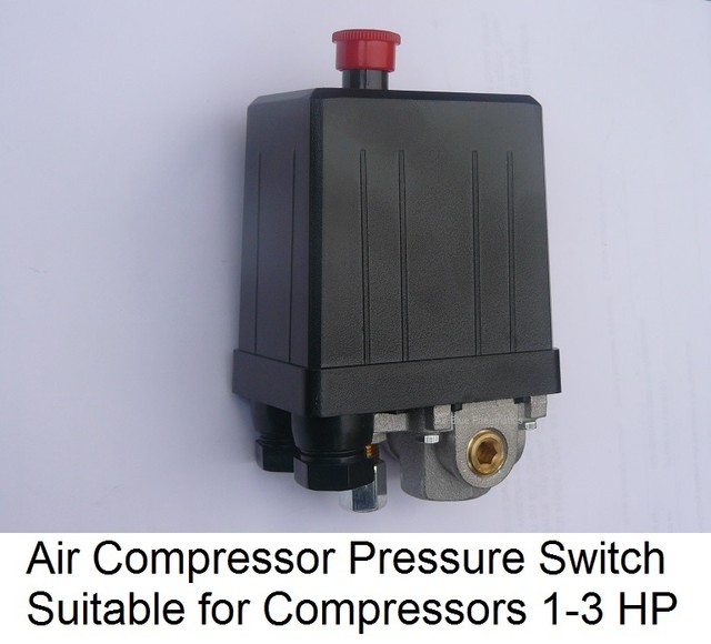

My ancient Clarke Bandit compressor is having a hissy fit - literally and metaphorically. It looks as if the gizmo arrowed is not cutting out properly and the over-pressure valve kicks in...got a blast of air in the eyes as I was down close and looking at it...not good.
The model still sees available and I've contacted Machinemart to see if a spare is available. In the meantime is there anything I can try ?
You could open it up and see if the contacts are sticking or welded shut. Maybe it is dirty inside. Try a blast of erm compressed air perhaps.
That device is more than a pressure switch it also is a dump valve that opens when the compressor stops to allow it to restart under atmospheric pressure. This is why you hear a small escape of air as it switches off and why you are always supposed to switch it on and off with the red button not just at the plug.
I would expect to be able to get replacements on eBay as they are very commonly used on DIY compressors not just Clarke badged ones
first one on ebay via google
https://www.ebay.co.uk/p/Air-Compre...ompressors-1-3-HP/1188192869?iid=182972342700
£9.95 delivered. Maybe worth a punt..
