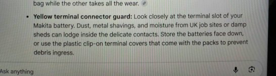

Continuing my 'discussion' with Google AI ended up with me taking around 21 screenshot photos with not being able to keep the formatting of bold text etc. It also took a sidetrack in regards to the workshop, if insulated - and how, and also if interested in a print sheet for various 'management of' the different batteries I have.
Hope other will find some of it - if not all of it! - of interest and if it may take you to ask the AI of your choice on your particular cordless battery range of tools 🙏😊
Just confirming that these relate to my cordless... if some members have the same then it could be relevant to them.
