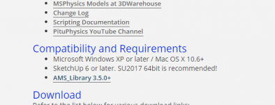

What is the error message you get when you try to run it? The last "stand alone make version is SketchUp 2017. According to the author of the extension, it is compatible with that version. There's also a required library file which is linked to in the Compatibility and Requirements section of his first post.

The not compatible message came up when I went to install. Think it said I could try it anyway but given the likely learning curve for something that may have a problem I didn't.

I expect the message was indicating that the extension hasn't been signed. That doesn't make it incompatible. But since the learning curve is an issue, then it's probably best you didn't proceed.
