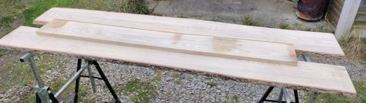

I've bought £48 worth of 25 mm thick Ash to use for this. My plan is to use a mixture of hand and power tools on this project so I can get it done a bit quicker than the tool chest!
These are the (planed on one side) planks:
If you click on this image for a bigger view, you might just about be able to read the dimensions:
In case it's not sufficiently readable, that's 25 × 200 × 1750 mm, 25 × 280 × 2240 mm and 25 × 240 × 2230 mm. From the drawing above I think I need a total of 4.6 metres of 200 mm wide board.

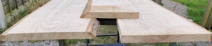

This photo shows what the end grain looks like:
Am I correct in thinking that it would be more stable if I cut it up into narrower strips and glued the strips back together? If so, how would you go about doing this? Just 100 mm strips and balance the grain in a U ∩ pattern? Or something more complicated? Or would you leave it as 200 mm wide and just accept that they might bend?
This is what one of them looks like with a straight-ish edge lying on it:
Given that the side of the board that this straight-edge is on is the one with the perpendicular grain, I'm torn as to whether to cut all the way down along that line or to follow the bark line. The advantage of following the bark line is that I'll get more of the quarter sawn stuff; the disadvantage is that I'd probably have to cut it into shorter pieces, which risks wasting more wood if I stick this through my (snipey) thicknesser.
Any and all help and advice appreciated! My only previous experience of making panels and such-like is using quarter sawn stuff (either by buying quarter sawn oak or by getting middle slices of a sweet chestnut tree and taking the outside bits of those slices).

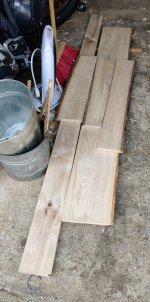

I have had long lengths of wood laying up the stairs for years the wife doesn’t mind and if they aren’t to wide they are in a place you never tread.
But if you cut them to rough length they will fit under a bed or standing up in a corner.
I’ve had some baltic birch ply atop a wardrobe for 12 years or more, the off cuts from a couple of Tripp Trapp style chairs. I am sure I had another project in mind for them :eusa-think:

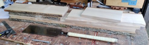

I knew I was going to have to rip the bark of one at the very least as it's too wide for the thicknesser, but on closer inspection two of them were quite bent across the width:
With that in mind, I decided the best thing to do was to rip them in half and thickness the two halves independently. Getting that bend out would have involved a massive reduction in thickness I think.
The outdoor workshop got set up:
The shorter piece stayed whole; the two longer and wider pieces got ripped very, very roughly in half with the tracksaw and then I fed them through the thicknesser.
I started with the planed (by Wentwood) side down and kept going until all the saw marks had gone, then scribbled some pencil on the planed side and fed the pieces through the thickness with that side up until most/all the pencil marks had gone. That left them a little over 20 mm thick. They'll get some hand plane treatment after they've been reduced to somewhere near the final length.
That involved emptying the cyclone dust box thing twice (having also emptied it before starting). That thicknesser doesn't half produce a lot of waste quickly!
The snipe was nowhere near as bad as I'd remembered to be honest. It's possible that the last couple of times I'd used the thicknesser, it had been in the garage (where there isn't space for me to lift the "wings" on the stand, which seem to help a lot). Or I might have been doing something else stupid, who knows?
You can see the snipe if you look closely, but you have to look very closely:
