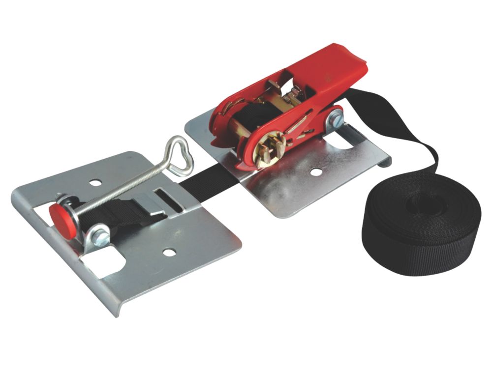

Jimmy Mack":2p4ztxej said:
......Liked to of got my joints a bit tighter........
Once you get into the middle of the floor there is nothing to brace against to lever them tight. It's a pain!
Mike G":2zhym3vw said:
Unless you use some of these ?
ae235
or you temporarily screw a batten onto the joists about 3" away from the last board and then tap folding wedges in to tighten up the floorboards/boards.

RogerS":j49kb3fe said:
Mike G":j49kb3fe said:
ae235
A set of those would of been very handy Roger...I think I could of put a bit more effort in perhaps with a batten and some folding wedges, as you say (Wedges, of which I have plenty, after cutting my rafters!)
