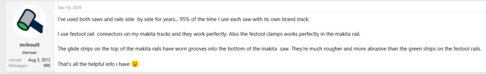

Does anyone know if the Makita saw track clamps fit the Festool tracks? I'm inclined to think that they do, but it would be handy to hear from someone who has used the two interchangeably. I'm buying a sink from a company that also sells the clamps, and whilst I've never had any problems with tracks slipping, they do seem to be a good belt-and-braces sort of approach. I'm inclined to just add them to my basket, and for once in France, they are not at a price that necessitates me selling a kidney.
Any experiences?
I have Festool track & Makita screw clamps They are currently not in the same location, so i can’t double check, but I think that the bars on the Makita clamps were just a smidge fat for the Festool track. However, I’d recommend the Axminster quick track clamps as a better cheaper option anyway for track use; you really don’t need much clamping force.
Of course they’re out of stock
Amazon reviews say the Makitas are compatible with Festool so my clamps or my memory might be aberrant.
Here is an ancient thread on the Festool Owners Group that indicates the Makita clamps will work with the Festool tracks with minor filing.
Amazingly enough the reference in the 13 year old post is still valid and is the same set of clamps you referenced:
They should fit.
The only significant difference between the two tracks is the extra flange right at the back (on top) for Makita's anti-tip feature. The slot underneath is, I think identical between the two brands, both in dimensions and position.
All my rails are Makita, but oddly, when I wanted clamps, the Festool ones (Acme thread version) were significantly cheaper. So I got those, and they fit pretty snugly, implying the Makita ones shouldn't be oversize in Festool rails.
