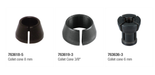

8mm is uncommon but 3/8" is a really unusual size to come across when it comes to router bits, you can get them but they're nowhere near as abundant as 1/4" and 1/2" bits.
Looking at Makita's site for the DRT50, it does show that there is indeed a 3/8" cone to be had.
For around £9 posted you can get the 8mm collet from here: https://www.powertoolworld.co.uk/makita-763618-5-collet-cone-8mm-for-rt0700c-rp0900
I’ll have another look later today. Drill bits is a good tip Andy.
I may end up buying collets just to be sure. Thanks for the link Trevanion.
I found some calipers and satisfied myself that it comes with a 1/4” and an 8 mm collet (just like Dr Al’s). The small collet is clearly a touch larger than 6 mm; it’s close to 6.3 mm. The large collet is clearly much smaller than 3/8” (9.5 mm); it’s close to 8 mm. That really only leaves one realistic combination: 1/4” and 8 mm. It’s annoying that the 8 mm bit doesn’t get any friction from the 8 mm collet until the spanners get involved (unlike the 1/4”), but I guess that’s just the way it is.

Mine (DRT50), and the RT0700 before it, came with 1/4in and 3/8in. Metric collet sets can be had cheaply from AimTools (directly, eBay and Amazon) in 6 and 8mm, etc - these are for the Katsu routers, which are copies of the Makita originals. I can testify that they work with the Makitas (as do the Katsu router bases, although they sometimes require a bit of filing to get a perfect fit)
