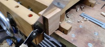

The first job was to hack the bit of cherry down to size a bit using my portable workbench and ryoba:

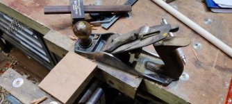

At least I'd left plenty of extra material on there! Next was a quick attack with a #4 to get it as close to parallel as my skills allow (which is to say, not very parallel!)

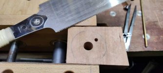

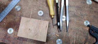

With that done, I could mark out a 60 mm diameter circle to give the shape that will form the body of the marking gauge (I'll flatten one side at some point so it doesn't roll of the bench, but that's a job for much further down the line).
I then used the compasses in pointy stick mode to mark a second hole location 18 mm from the centre:

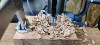

I then drilled out the offset hole, starting with a 6 mm wood drill and then following with a 6.3 mm HSS drill:

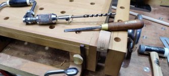

Next I decided to be brave and try the brace as I have a 9 mm bit. I used a 10 mm chisel to make a flat surface on the edge (probably unnecessary, but I figured it couldn't hurt) and lined up one of the lines I'd drawn on the face with the vice jaws:
Nothing for it but to have a go:
That worked really well, so I did the same for the other end of the hole:
and one more time resulting in this:
Next up was a 10 mm chisel (and a small pair of pliers to for easy waste removal) to shape the hole properly:
As I got near the bottom of the hole, I turned the block round and put a piece of dowel in the hole to limit break-out:

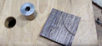

I started with this offcut of American black walnut, which I cut a quarter off:
I then tried to plane it to a nice consistent 10 mm thickness. Thankfully, there were four quarters as I was relatively successful on my third go :oops:

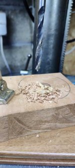

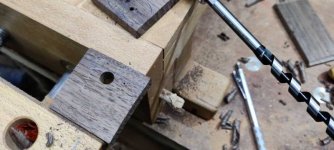

I thought I'd try the brace again, firstly to make the shape in the nook between the handle and the circular bit. I drilled most of the way through (until I could feel the point appearing at the back), then turned it over and drilled from the back, using what I thought was the hole from the previous drilling. Unfortunately I somehow picked the wrong dot and ruined the part:

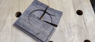

Remember how I said that this was the third of four quarters? This is the fourth:
After drilling the hole to form the outer shape, I drilled the centre hole, starting with a 6 mm wood bit and then finishing with a 6.4 mm HSS drill:
I then started cutting round the profile. I thought I'd rough it out first with the ryoba and then figure out how to shape it properly afterwards. As soon as the saw started cutting, this happened (which I guess I should have seen coming):

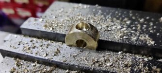

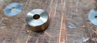

Off I went to the lathe and chucked up an offcut of brass bar:
A minute or so later, it looked like this:
