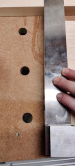

im not sure i mentioned this before, I have setup my mft (sister decides she wants a cutting board). checked the fence against the back of the rail and have a perfect 90, checked with a 12" and 10" machinist square as well as a shinwa and all look good. run the cut and one side is >1mm out. could it be possible the the rail is out on the cut side? or the saw is punky? its not that old and has hardly had a bad life.
i did make a shooting board, and realised i suck at that.
any ideas would be a help, something to note that on the end of the cut it seems to deflect in a bit, wondering if going ack to an original blade might help as i swapped the original out for a key blades one recently....alas i dont remember if this was a problem previously or whether i changed the blade because of it.
well first things first, a new blade ordered and a splinter guard change, dont reckon its going to help though. i spose i could try my 1400 track to see if that helps otherwise i see no other option than to send it in.
scrap that, clipping on the end seems to be a wear fault, not that it gets much use so just put in a repair request and will send it off instead
