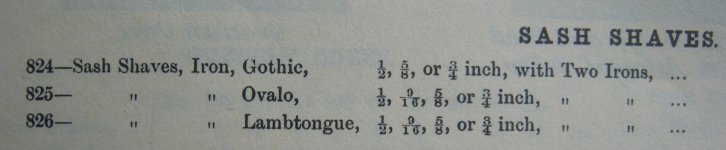

The shortest and simplest answer I can offer is to look back at the catalogues where Preston and Mathieson listed these tools.
Here's Mathieson, in 1899. Three different profiles, four sizes, but no 9/16" Gothic :(
They illustrated these with just the gothic variant:

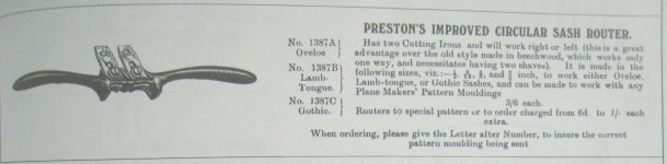

Here's Preston, in 1909.
Three different profiles, in four sizes. Maybe with a nod to the future collectors market, they offered the full range of twelve, plus specials!(y)
So both makers knew the difference between the gothic and ovalo profile. They included handy charts in their catalogues. Here's an extract from Mathieson's:
You can see that the curved part of a gothic sash bar was very similar to the curved part of an ovalo sash bar. I think that's why, in practice, there it's really hard to spot the difference between the shaves offered for circular work to match them. Indeed, I expect a skilled worker could have used one tool to make either style, possibly by reshaping parts of the cutters so that different parts of the shape cut or don't cut, and maybe by making a rebate before cutting the profile.
I think you and Robin should try the gothic and ovalo variants as they are and see which bits do actually cut.
There would have been some variation in sizing but let's keep it simple and remember that the 5/8" measurement is the distance from the very edge of the moulding bar to the little notch that defines the end of the shape.

Mike, these are strictly for curved work. Think fanlights, arch headed windows etc.
On straight work you select your stock so that you plane with the grain when making the moulding.
On curved flat work you always plane downhill. But if you were running a moulding along the curved part of a fanlight, you need a mirror image of the moulding so you can work in either direction.
The copy text from the Preston catalogue mentions this as an advantage of the improved pattern.

Looking back at the text in the Preston catalogue, there's the claim that their cast iron design "has a great advantage over the old style made in beechwood, which works only one way, and necessitates having two shaves". Maybe we shouldn't expect tool manufacturers to be the best tool historians, but that ignores the existence of this wooden double version and implies that there was only a single handed version. There don't seem to be very many of these around, but here's a picture of one by John Cockbain of Carlisle, again from the Cooper's Tool Museum:
