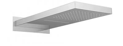

The shower head is a big lump sticks out 500mm, with rainfall/waterfall option all came from Porcelonsa:

Got to admit those rainfall/waterfall heads can be a bit of a pain you’ve certainly got to get your pipework spot on if the head is gonna fit when it’s all tiled, did this one a while back.
