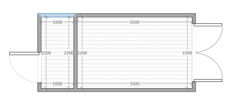

Hi,
Ive got a few projects to complete in the garden all permitted development, Ive got a shed with log store, a summer house, a gym and a chicken run/coup, I'm going to follow the concrete slab with brick plinth idea for all 4 of them, I have been sourcing materials and have dug out the slab for the shed which will be the first project,
The floor plans are shown below:
The log store is at the rear its not that big but I think it will be enough for our needs as we are going to have another log store closer to the house, the shed will mainly be for storing tools and my ride on mower.
So I've dug down 200mm to give me 150mm hardcore and 100mm concrete with 50mm of the slab above the ground level, this actually ranges from a few mm to about 60mm as the ground slopes, I will level this after completion.
Do you think 150mm hardcore will be enough, bearing in mind this is just a shed and will never likely be used for anything other than mowers garden tools etc?
