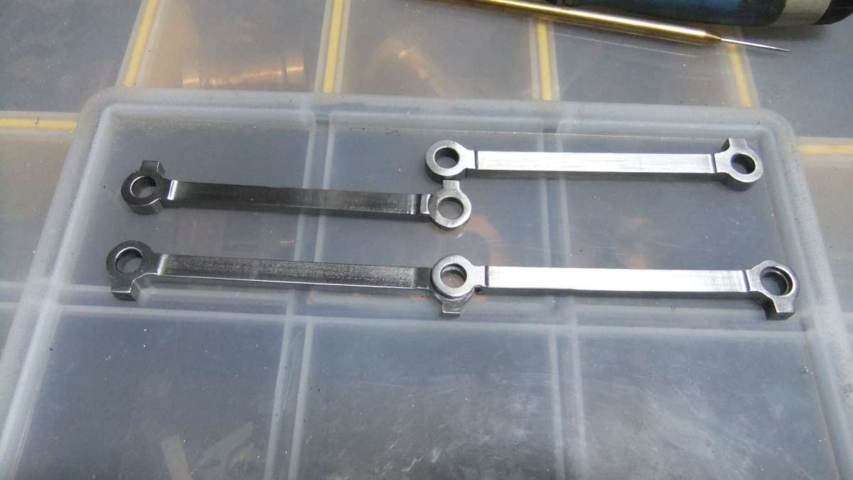

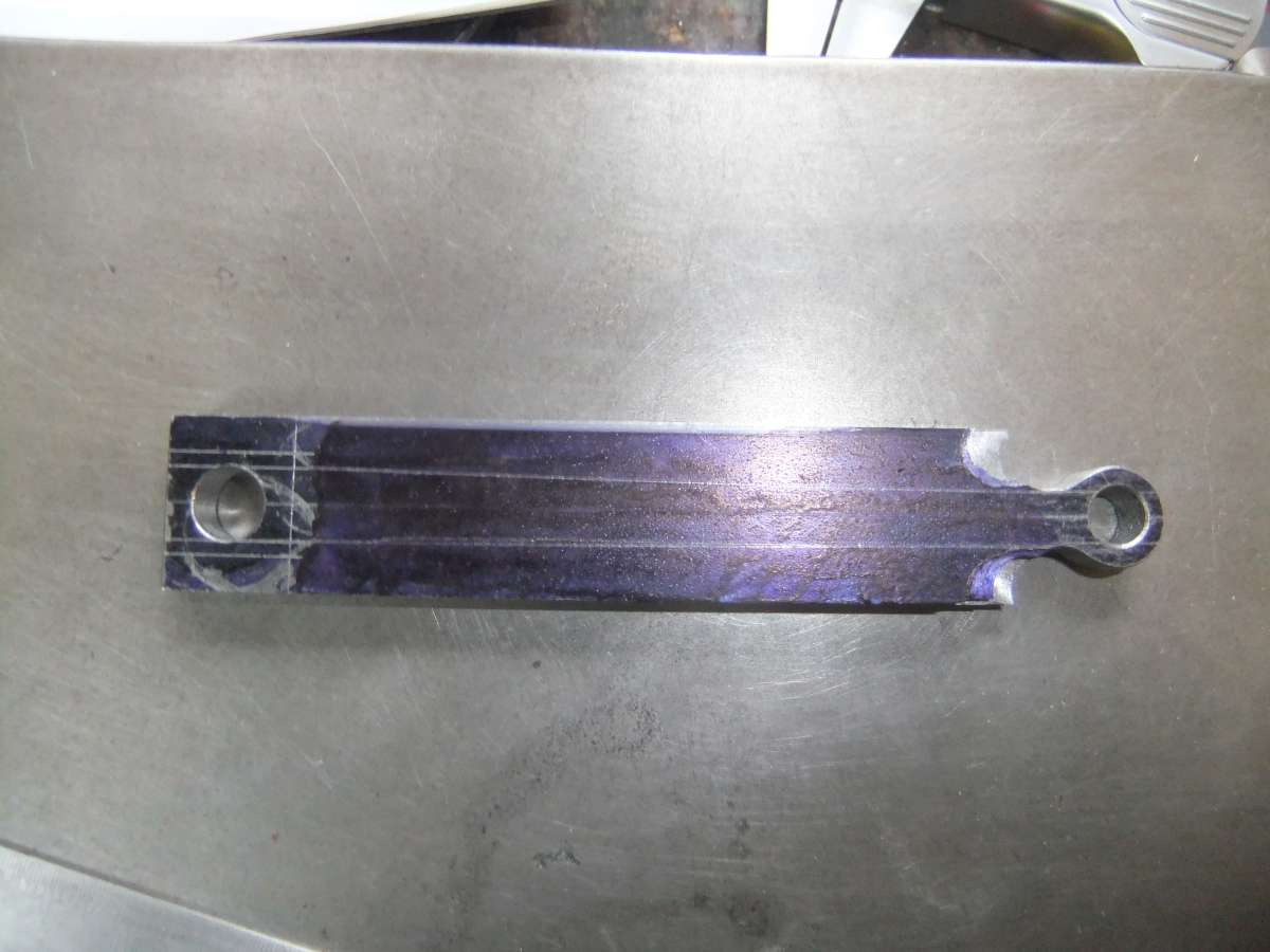

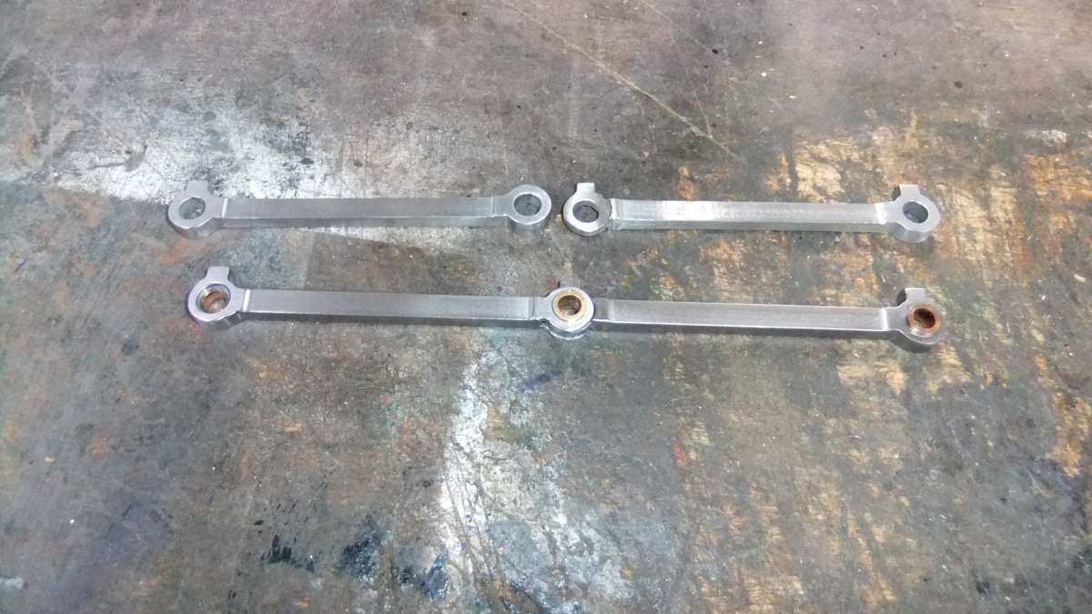

While waiting for some HSS tools to complete the cross head I thought I would finish the coupling rods which I started ages ago but stopped because I needed to sort out how I was going to proceed. Now that I have done more machining on other parts, I felt comfortable to get them finished.
How I left them
DSCF2530
DSCF2538
Where I am today but with a small bit more to do.

Lower set complete and bushes installed.
