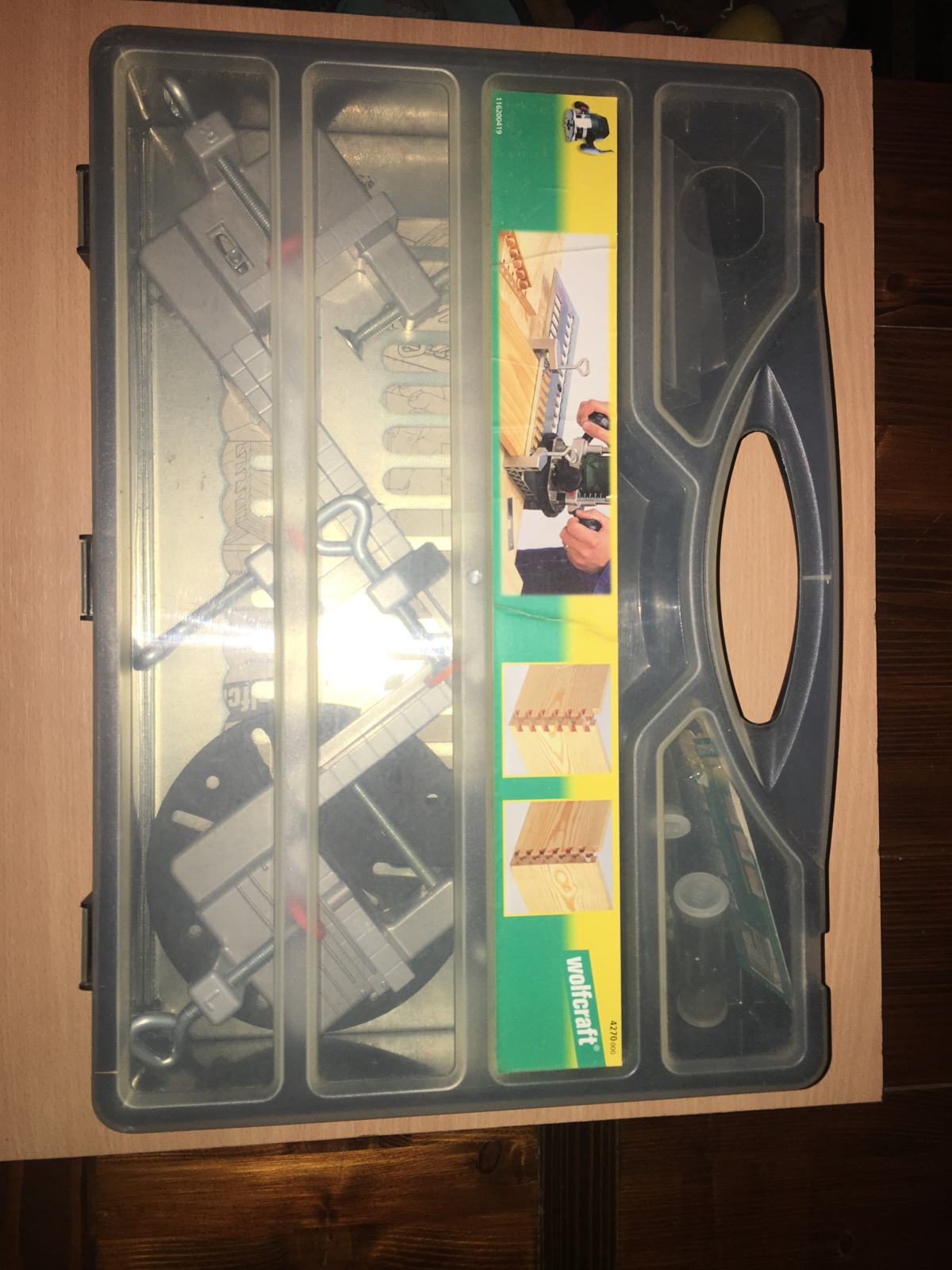

Could it be for routing box(finger) joints? The width of the offset equals the width of a gap or a finger, so by offsetting you can rout all the gaps at once.
