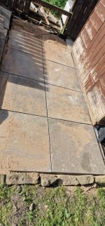

Anyway, had a sleep. No more runny *oo. Was aware of the work I'd done getting them flat and bedded so didn't want the sharp sand washing out. Got out there and made a semi concrete mix (1:2:3 of cement:sharp sand:building sand). Just about had a nice consistency, whacked the first blocks down and started squeezing them into the gaps. Then the rain came.
It went from light to semi heavy to properly wet (me). But managed to get the mortar in the gaps and covered it with cement mixing plate and a small plastic swimming pool. Hopefully it doesn't all become a runny mess, but at least it'll dry slowly 🫣.

Latest pic as it is now. Thankfully when lifting these 41kg slabs I've just about managed to 'not cripple' my back. I'll keep trying to be equally as carefully. Also, that sand I'm being sure to recycle it and thats what the blue swimming pool (and white builders sack behind it) is for. Gonna take some levelling methinks and a hedgehog house build on the back of the side of the shed...

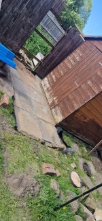

I reckon I have whacked enough rocks to make a decent amount of concrete for some thin footings. So dug another bit out on the side (where I'm trying to stop the neighbours fridge from grow20260629_194132.jpging into my garden) for ant extra concrete. That'll have to have a few bricks set in as I bring it to level.
The joys of making it up as you go along. The theory is that the rotten posts will eventually come out and I may have a decent amount of footings for a very low level wall. But, that will happen as time moves on (maybe 20 years from now 😆).

Somewhere here between the posts I reckon will be my hedgehog highway, but we shall see. I need to figure out a way that he'll naturally stop throwing his carp right up against the fence, but I'm not saying that is the reason my posts rotted in 12 years. That'll be all on me and I plan to bitumen around them this time, aside from the fact I have the correct grade of posts for ground contact!!
Somehow managed to create a slight slope away from the posts (not very good at levelling concrete, thankfully it does most of the job itself). Second bit further up is gonna be a head scratcher as the slope is being removed rather than buukt upon there!!
