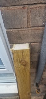

Quick update folks as, with my garden and life, I always feel like I'm in one of those old western movies preparing for the winter months...
As if the garden wasn't an obstacle course enough, my little boy decides to build a little pond but without staggering the bricks. So an extra problem to get my post-op routine around. Still not allowed to lift heavy so it will be interesting how I'll smack these makeshift posts/supports into the ground to stabilise the rest of the fence. Concrete and new posts can go in next year now!!
Also, started closing up the fence to try and keep his weeds out for another year!!
Pic below!
Now I've only gone and misplaced my shed and fence (read, cheap rubbish) paint brush which I would have smothered more paint into the stake ends of the 2 posts I've just cut down!!
