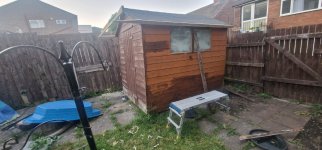

Currently I have a 2.4 × 2.4 (approx) footprint. Nighebours side fence which must be a brick wall is on the left. Everything will hopefully get done in stages and attached as/when needed and able to.
Eventual size will be a (less than) 15m² footprint and this weeks 'job' was to repair the roof and make the front face level.

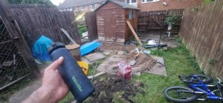

Got myself a 3m pressure treated length for £8 and ripped it down. This has not only added an approximate canopy/shadow/footprint area as to how far forward to come. I added the angle to finally start making some of the roof level (the new bit).

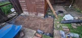

Then the 600mm² concrete slabs had to come out and be made level. Removed lots of topsoil. Kept as much sharp sand from underneath as possible. Took the top soil to the tips (12 visits now per household per year for DIY waste) and levelled up.
Grabbed some geotextile membrane after cross referring one of Mike G pics/threads. Also, might aswell get the front footprint a bit wider already so dug out another 2 slabs worth.
Today was eid, so I did what I could. Had probably removed too much topsoil, so needed more sharp sand. Another trip to Wickes (local UK hardware store) and some more sharp sand purchased. Total cost now including the woven 2m x 25m geotextile, sharp sand and that initial treated 3m length (which was to get the ball rolling, so essentially a priceless purchase), £50.

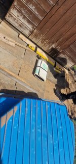

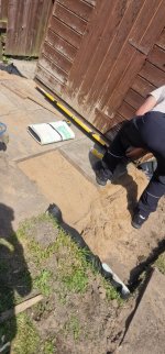

Took a bit of a while, using the long level attached to a length of timber and lots of care. It wasn't until slab no 5 & 6 that I'd found/remembered my how-to (last slabs laid will over 20 years ago but they were even heavier at 900mm x 600mm).
I'd used my joist/workbench to compact the ground before the sand. Now I was using a second length slightly shorter to flatten a full 2 slabs worth before throwing down a slab. The underlay for knee protecting duties before eid-duties (going out) called.

1. Newly moved plum tree from below 'no3'. This is in its 3rd year and given fruits once. Trying not to kill it off so must be careful.
2. The work in progress with addition of a frontal area to the current shed. Also being extended to the right by 500 - 600mm (the width of a slab). This might keep the wife appeared with at least one of my bikes God Willing.
3. The back fence which also has a rotten post. This goes onto a path that we thought was the council owned (access to the houses from the back) but they deny it. So fortunate old me has the chance to try and upkeep it (I weed it once a year and gather all the litter up the end of the path every season, or as able).
So no3 could be either a timber framed wall on the boundary or brickwork. Brickwork probably cost restrictive. Its another drop there which leads me to no5.
4. The neighbours side fence which is wobbling. This may as well and has to be a brick wall to allow for local buildings regs so as to being fireproof. The roof (eventually) will be an apex type thing (leaning towards my side to allow water run off into my garden).
5. Another step down floor probably much the same as these slabs I'mdoing now. But will see when I gets there. This time backwards as the slope is substantial. So I may as well gain as much cubic m³ (sorry ft³ people) as possible.
Hope that makes some more sense. Can't move the shed to the right or it would cover up the gate and not have a platform. Moving to the left reduces my working area as its already a bit tight. Don't fancy working from neighbours garden too much (fridge, sideways and everything else).
