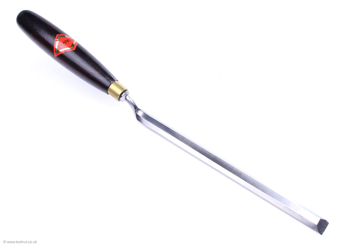

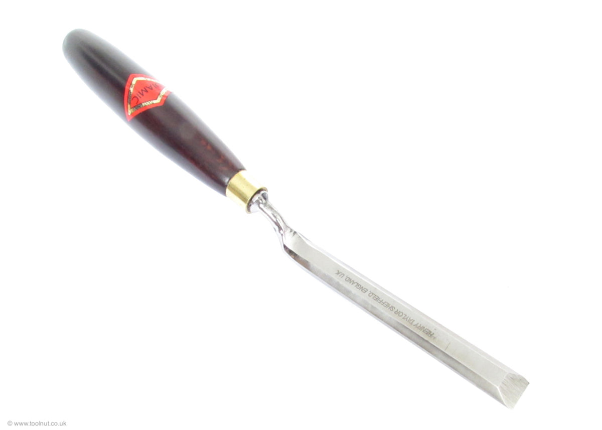

Well, if you're forced to have such a wide flat area in front of the work, it's a good job you've got a fancy cranked chisel to do the delicate paring!😏
Well, there are other ways to skin that cat but one nice thing about the mitre jack is that it raises the work to a more comfortable level than, say, bending over a bench vise.
I'd love to have a cranked paring chisel. I keep my eye out for them but I think they're quite unusual aren't they?
They're still made, in Sheffield, by Henry Taylor, in a choice of width and length:
You're a bad man! I knew you'd know where to find them!

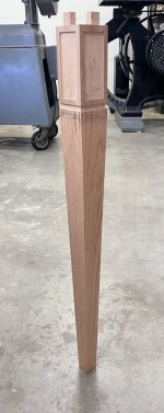

Although I was looking forward to seeing you do the fluting on the legs, that design does look more of a whole, I think.
One leg tapered today plus a simple recessed field at the top. Band saw and hand planes for the taper.

I haven't quite given up on flutes. I played around a little with Sketchup to see whether I would like them. It turns out to be really time consuming to draw actual rounded flutes so these are just square grooves and it looks a little busy to my eye. If I did it for real I'd probably stop them short of the mouldings. What do you think?
My thoughts are that I like the bottom third a lot, the proportions are just right, the top is pretty good it’s the bit at the top of the tapers that looks like it needs just a bit of something to my eye.I’m referring to the actual leg not the drawing btw.
I agree it's a bit "busy".
I wonder if they might look better if they're less evenly spaced - i.e. have the flutes grouped closer together with a slightly larger border at the edges?
I was thinking something like this (without the foot), but I couldn't draw it. Something decorative in the recessed field would be nice, too, but that won't happen.
