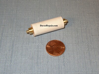

Here's what I have not fixed today. A 1970's era Sunbeam Mixmaster mixer. Belonged to my wife before I met her. Sometime in the last couple of years it developed the symptom of starting up when it was plugged in, could not be turned off, could not adjust the speed. We rarely use it so I just ignored the problem until it was time for Christmas baking. Wife asked me to fix it. After poking around online I found that the symptoms could be caused by either a bad capacitor or a bad resistor. I opened it up and found this:
Which I believe is a bad resistor. Unfortunately, as far as I can tell these are no longer available new and only rarely available from parts machines. I'm kind of stuck for now.
Do you have a value for the resistor and its power rating?
this one seems to be suggested as a replacement https://www.mouser.co.uk/ProductDet...0XCQvmsnPF98FoJHV7cCVmpwZboe7q_fhZ-tF3qlVBODw
Looks more like a capacitor. Resistors are much smaller

It’s a resistor you can see the coil of resistance wire. Size isn’t anything to do with components.
Good point Pete. Have to confess to never seeing a resistor like that before.
Gary…what is the model number or type ?
I at first thought it was a capacitor, based on this image and description. The size is exactly the same as the burned out piece. I bought one and installed it, but that did not fix the problem. But as the note suggests, the capacitor and resister are sized similarly and the capacitor is the lower one. The burned out one I show above is the upper one, so I assume now that it is the resistor and what I have now is a mixer with two capacitors, one of which may still be bad, and that I now need to replace the resistor.
OK, I think I have this figured out, now. After a series of emails with a guy who specializes in repairing these mixers, I found that I had been reading instructions for a different model of this mixer. That degraded cylinder was indeed the resistor. He said the covering often flakes off but that the resistor in that condition usually works as well or even better than an intact one. Unfortunately I had tossed it so I need a new one anyway. The problem is the capacitor, which on my model is a wafer style rather than a cylinder and is located further into the guts of the machine. I dug in and found that the capacitor had indeed burned up. You can see the scorch mark.
Neither resistor or capacitor are available new, but repair guy keeps a stock of salvaged and reconditioned parts and he's sending me what I need.
The new goodies arrived yesterday and I installed them today. The mixer works, now. No pix so you'll just have to trust me.
