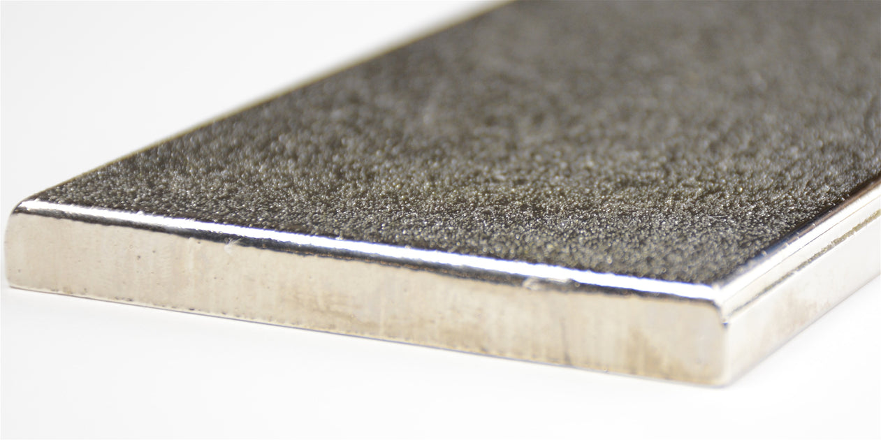

As diamond plates wear out, do they take on the role of a plate with a higher number?
My 600 grit plate is no longer as efficient as I remember it being iinitially. Can I shuffle it along and use it as a 1000 or 1200 grit plate?

I don't know Mike, but I suspect the edges of the particles just get blunt so that they don't cut well rather than cut finer.
Worn abrasive, of any nature, does not become a finer grit, it just becomes blunt.
That's why people who rub together two pieces of sandpaper to make it "finer" are idiots. All that happens is that neither piece does its job properly.
Diamond stones are no different in that regard.
The size of the abrasive particles does not change due to wear. It is just that the sharp edges facing your workpiece break off. The result is that the scratches will still be spaced apart the same as when the abrasive was sharp, but the scratches will mostly be less deep. In other words, you will have to work harder to remove the same amount.
They do wear out. Quality varies. The guy in the link suggests a 10+ year life depending on usage and claims that cleaning may be effective to get rid of swarf build up clogging the stone.
...... cleaning may be effective to get rid of swarf build up clogging the stone.
I bring mine into the house every so often and give them a scrub under the tap with a scrubbing brush and detergent. It's not cleanliness making mine less effective, but one of them is just worn out. I'll invest......

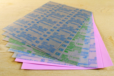

Getting into dangerous territory but have you tried these?
I bought some maybe six years ago and still haven’t used half of them.
Use a diamond plate (does anyone remember when trend sold a lot very cheap?)
Then go up the grades with the film and final autosol strop.
