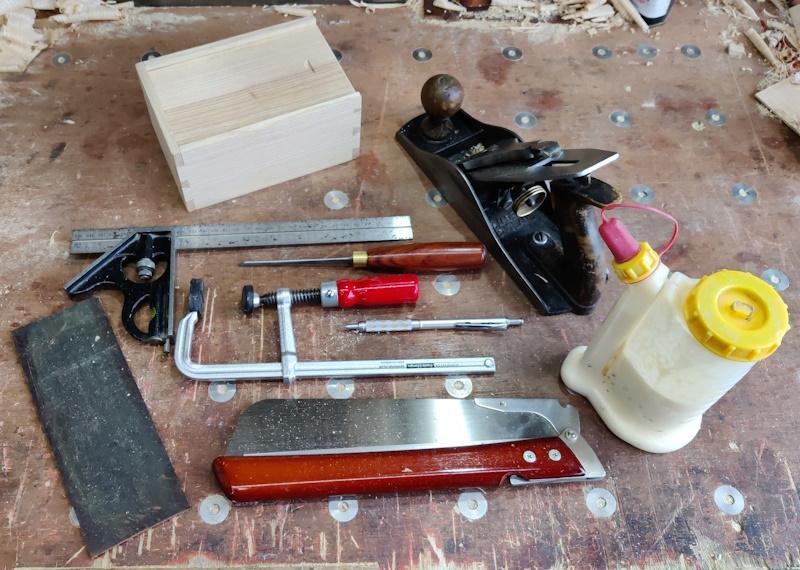

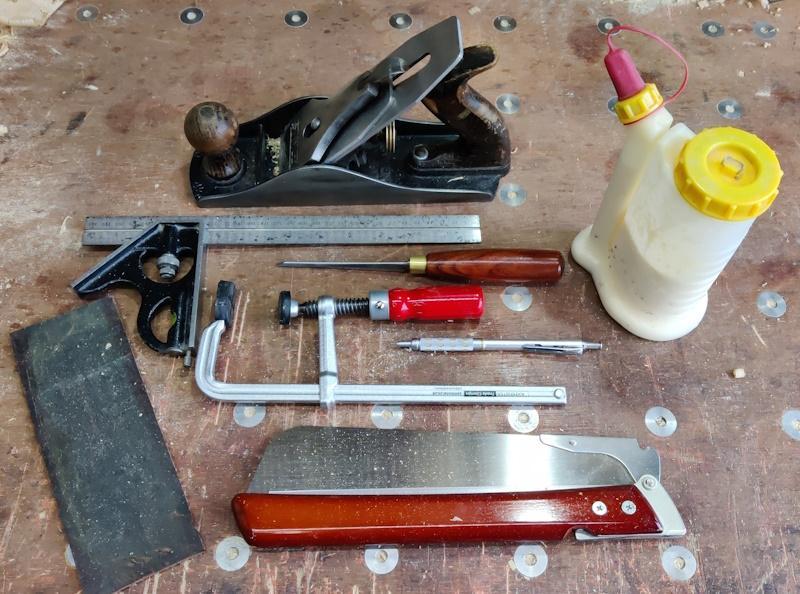

and this is my initial set of tools:
I suspect I'll need more in due course, but this seemed like a sensible set to begin with. I'll also add some finish of some sort to that list, so that'll be 9 tools I think in total if I manage not to need anything else.
My tool set described in a bit more detail...
Definite:
  • Stanley #4½. Seems a good compromise size; I'm sure a #4 would also be fine.
  • One saw - probably Kataba, possibly Dozuki. A Ryoba would probably be a good option, but I'm sure someone would argue that it's two saws as it has two sets of teeth!
  • Combination square. This can be used as a square and also as a distance gauge for marking board thickness.
  • 6 mm chisel. This will be used for paring and chopping; it has to be small enough to get into the pins. Ideally it is also small enough to not need a hammer, so 6 mm seems a good option.
  • An F-Clamp. If the joinery's good enough, it won't need clamping. The clamp will be for holding stuff to the bench for sawing and planing.
  • Pencil for marking which piece goes where. Arguably I could cope without this, but that sounds too hard!
  • One thin cheap diamond sharpening sheet (1000 grit probably).
  • Leather strop.
  • Fish glue.
  • Oil/other finish of some sort.
Maybe (I'll avoid if at all possible):
  • Hammer (if the chisel is sharp enough I might get away without this).
  • Another F-Clamp.
  • Paintbrush for applying glue (I'll try to just use my finger and see whether that works).
  • Damp cloth or similar for glue clean up. If I'm very careful, I might get away without this, although if I don't use the paintbrush, being careful might be difficult!
  • Something to clean up the finish and also to clean blades after sharpening (paper towels probably).
Notable absences from my list:
  • Marking knife. I'd normally consider this an essential, but the plane iron has a sharp corner that I hope will serve the purpose.
  • Honing guide. I usually use a honing guide as, while it adds about 15 seconds to set-up time, it saves that in sharpening time as you can move the blade so much faster on the stone; it also gives a more consistent edge so saves time regrinding later. However, I'm trying to minimise tools here, so it has to be out.
  • Shooting board. One of my most used tools, but I think I can cope without.
  • Bench hook or equivalent. I'll just clamp the board to the bench with the end hanging off.
  • Vice. I'll have to find ways to cope with just clamping stuff to the bench.
  • Bench dogs / planing stop - I'll assume that the only thing available is a sturdy flat surface. I can clamp offcuts to the bench to use as stops.
  • Bandsaw :) - so resawing the board for the box top & bottom is going to be hard work (especially without a vice)!

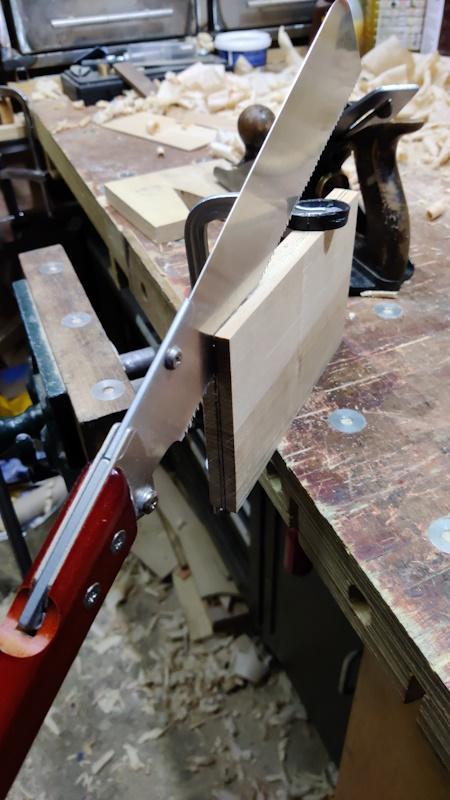

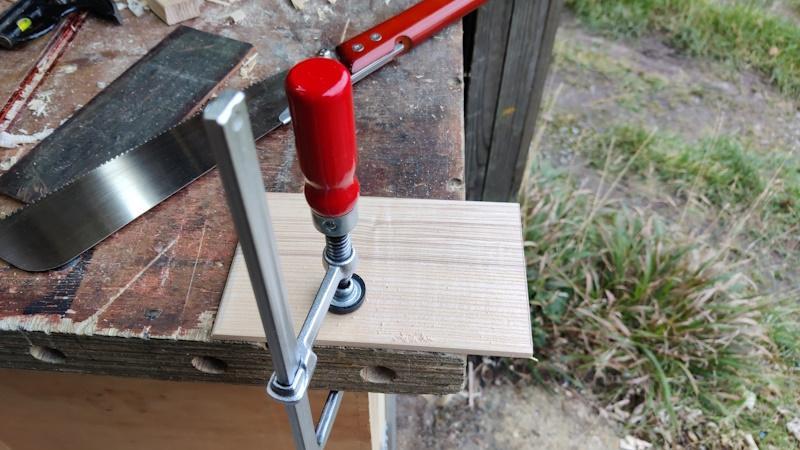

I started by shortening the board to a more sensible (and rather arbitrary) length so I had something a bit more manageable to work with:
Then I drew a straight-ish line (my combination square isn't that long, so I just accepted straight-ish) and sawed off the bark:
It was a bit wobbly with only one clamp holding it down, but it worked.
I then used the combination square to mark a fixed distance (about 85 mm I think) away from the sawn edge:
I'm not worrying too much about actual sizes at the moment, that'll come after planing. I sawed that bit off and also sawed a thin bit (about 8 mm wide) off the other side:
All the bits cut up for now (including a random little block that I had an idea to use but didn't in the end):

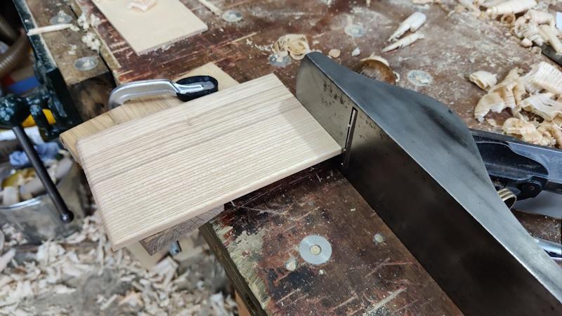

The thin bit acts as a planing stop: it's quite long so the plane doesn't crash into the clamp at the end of the stroke (this will be more important once I get the thickness of the plank down to something more sensible):
I haven't finished flattening one face yet (and haven't decided whether to chop it up into bits before doing so). Once a face is flattened it needs to come down in thickness by quite a lot. I haven't decided whether to try resawing (which I'll almost certainly have to do for the box lid and base), or just to keep attacking it at with the plane. I'm already wishing I'd included some wax (for the plane base) on the list, but I'm trying to resist adding it for now.

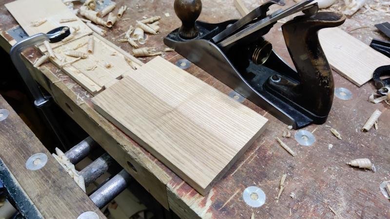

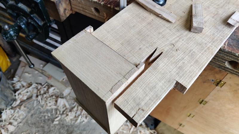

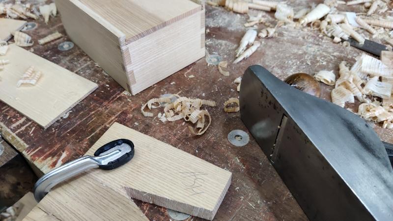

I left the board yesterday with one face planed and not much else done. The first job this morning was to plane the edges. I started by cutting a notch into the end of the off-cut:

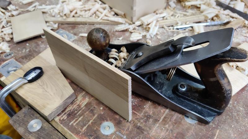

... and then chopping it off the end of the board and clamping it to the bench. It could then be used to hold the board while getting the edge square and straight:
I've never used that method of work holding for edge planing (I usually just hold it in the vice); it worked really well and I'll probably use it a lot more in future - I might even make something that drops into the dog holes for ease of use, but that's for another day and another project.

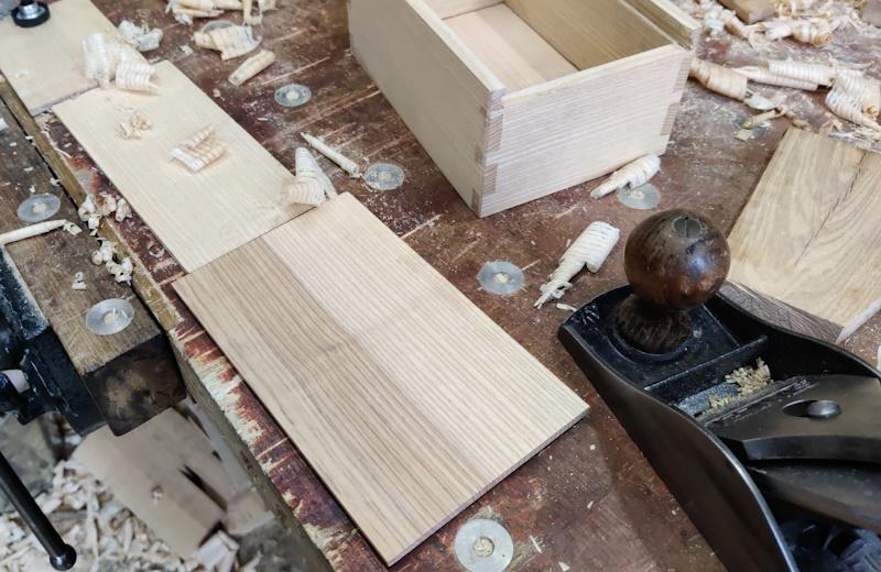

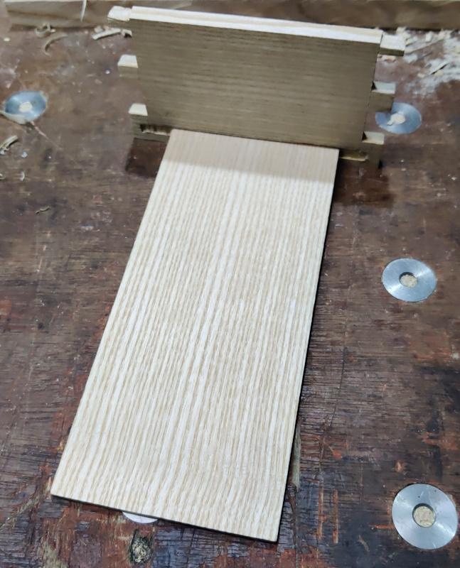

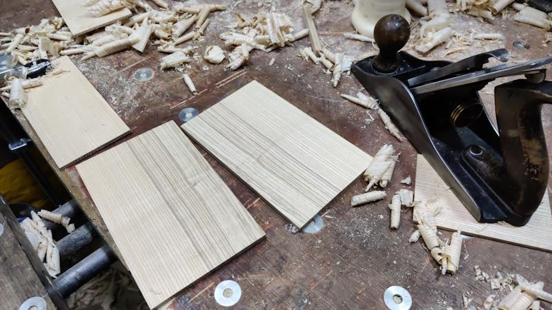

At this point, I decided to chop the board up into four pieces and work on them separately. I slightly regretted this later, but it wasn't a big deal.

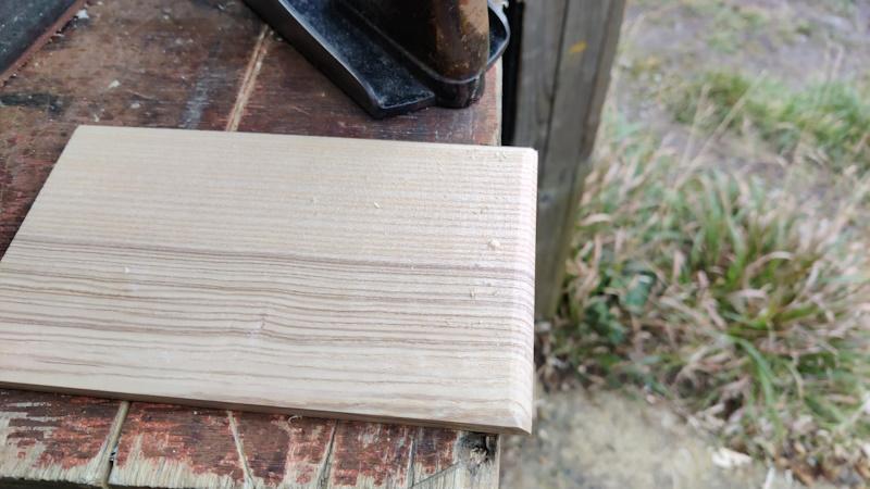

The width of the boards was marked up (purely based on the widest I could get out of all four pieces):

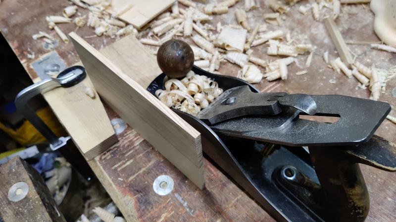

I then planed them down to the line, checking for square and comparing the board widths to each other periodically. This was the stage where I regretted chopping them up so small as the notched stop thing didn't work as well as a vice with such a short length of board.

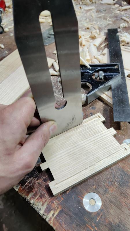

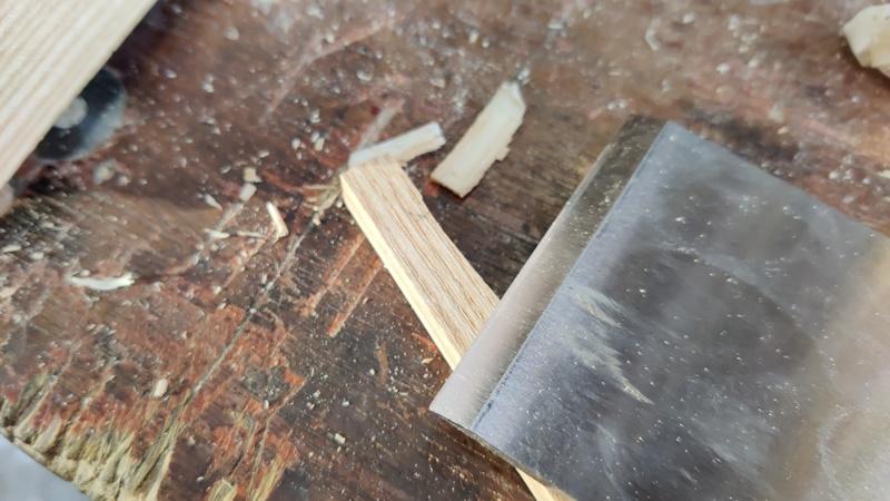

Next up was dismantling the plane so that I could use the blade as a marking knife. I took the opportunity to strop it a few times on the leather piece; I still haven't needed to use the diamond plate yet; I thought I may get away without the diamond plate if I get in the habit of stropping very regularly.
I used the combination square and the plane iron to mark thickness of about 8 mm, which seemed reasonable for a box this size. The plane iron worked well; the lines aren't that visible in this photo, but they're clear enough in reality (I went over them later with a pencil anyway for clarity):
The next job was to remind myself why I bought a bandsaw: resawing. The process was straightforward enough: clamp the piece upright to the bench (this was why I made sure both edges were square before starting resawing) and attack it with the saw:
I dislike resawing enough when using my big 300 mm Ryoba (with progressive 7 to 4.5 TPI rip teeth). It's even worse using a Kataba with teeth that look to be designed for cross-cutting!
Anyway, one plank done ready for planing; three more to go (plus the pieces for the top and bottom if I can't use the offcuts from this resawing operation):

That was really hard work, but all four pieces are resawn down to a more respectable thickness now:
The offcuts from the smaller pieces were used as planing stops:
I didn't leave much excess material when sawing (my sawing is getting more accurate!), so it didn't take long to plane them all down to the line. The offcut from one of the long sides was thick enough that I'll be able to use it as a drawer bottom; unfortunately I meandered a bit when sawing the other long piece, so the other long offcut is too thin to be usable, so I'll have to do more resawing (or think of an alternative plan for a lid) :(

With the lines marked on the end of the board, I clamped the board to the bench and sawed as close to the line as possible, again wishing I'd chosen a rip saw rather than a cross-cut one:
To try to save the work for the chisel, I also sawed a load of intermediate lines and then came in at an angle to get rid of as much of the waste as possible:

After struggling with the marking up method shown in the last post, I decided to try something different for the last two:
That worked much better and gave me a crisper line to work to. Unfortunately, on one of the joints I then proceeded to saw very carefully on the wrong side of the line on both sides of one of the pins, so I've created some gaps that will need filling later. C'est la vie: I'm certainly not going to remake the part now!

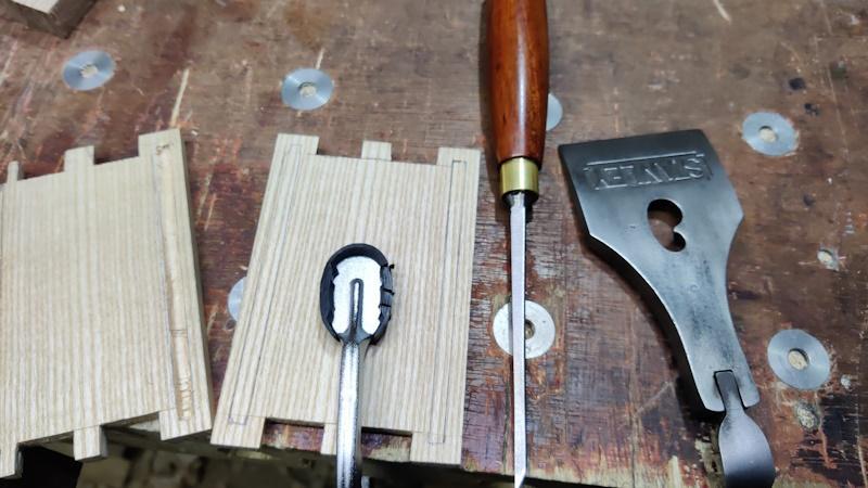

With all the joints made, I could do a test fit and transfer the groove locations across onto the end pieces:
This was the pin where I sawed on the wrong side of the line:
Chopping out the blind grooves was done in a similar way to the previous grooves. The only difference was I chopped down at the end to start the grooves off. This was getting quite hard on the last one; I suspect that's because, despite regular strops on the leather, the chisel is probably in need of a proper sharpen now after all those dovetails. To eke a little bit more life out of it, I used the lever cap from the plane as a hammer for the last few chops:
With all the grooves chiselled, I could get the piece I'd carefully planed to thickness to be the base of the box. Now if only I'd chosen a piece that was actually wide enough before I'd done all that planing. D'Oh!
A new piece was sawed from the plank and I planed both faces:
I then tortured myself a bit more by resawing it in half with the cross-cut Kataba (why oh why didn't I choose a rip saw!)
The resulting two pieces could then be planed down further.
Looking at the plane blade, it's clear that it needs sharpening, but stropping it on the leather seems to be letting it keep cutting okay, so I'm still managing without a sharpening stone thus far.
The edges were planed to size in the same way as before:

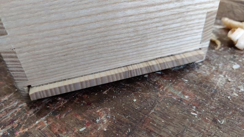

A chamfer was added on the bottom edges of the base. The pockets were also tweaked slightly in size by using the plane blade as a wide chisel:

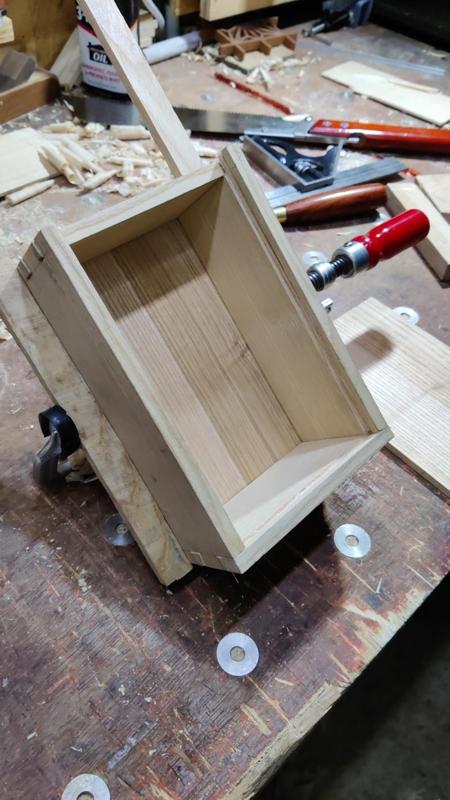

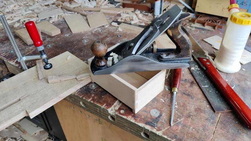

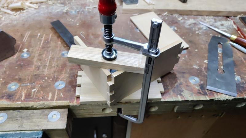

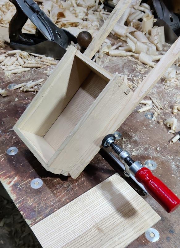

Then glued the box together. With only one clamp in the arsenal, I had to be a bit creative with holding it together, but the joints are very tight, so it probably would have been fine without the clamp in all honesty.
Once the glue has had the night to cure, I'll plane the outside faces and fit the lid. I'll also do something about that gappy dovetail joint.

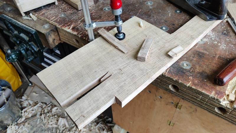

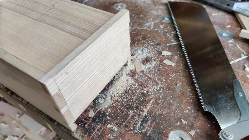

To help planing the sides without a vice available, I cut some notches in some of the leftover ash:

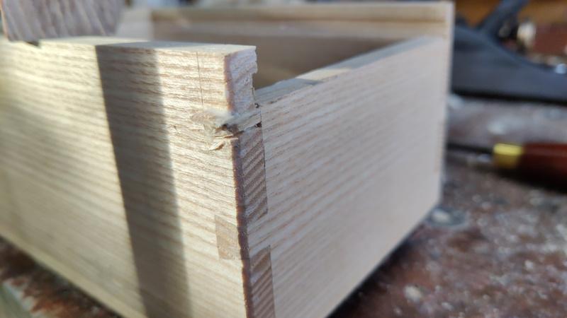

Unfortunately, as soon as I did the first pass with the plane, the bottom of one of the sides snapped off:
I guess the groove wasn't big enough. At least it was a fairly clean break, so I used the plane blade to enlarge what is now a rebate in the snapped off bit. That should give plenty of clearance for when I glue the snapped off bit back on.
To save working my long-suffering plane blade (which has had a lot of stropping but still hasn't been sharpened), I sawed the ends off the tails and pins where they were long enough to do so:
I could then use the notched offcut to plane the sides...
... and the ends:
While the offcut was clamped to the bench, I also used it as a planing stop to plane the top surface:

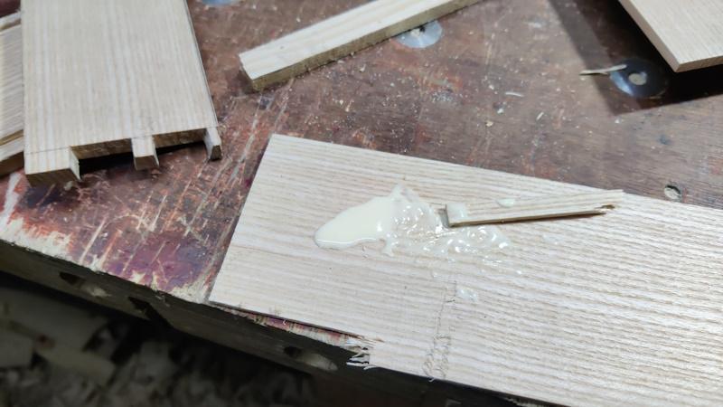

That done, I figured the best thing to get on with was gluing the broken off bit back on again:
While that was clamped in place, I used the plane blade to pare off bits from an offcut:

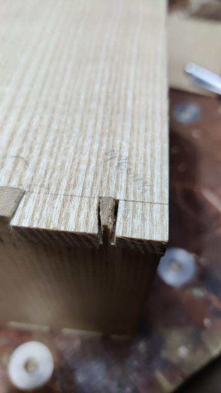

Two of those pared bits were smothered in glue and shoved into the holes where I sawed on the wrong side of the line. This photo was taken after inserting the first one.
They were hammered into place with an offcut of ash (actually the notched piece I used for edge planing earlier).
I don't think it's going to look beautiful, but hopefully it won't be as obvious as it was before.

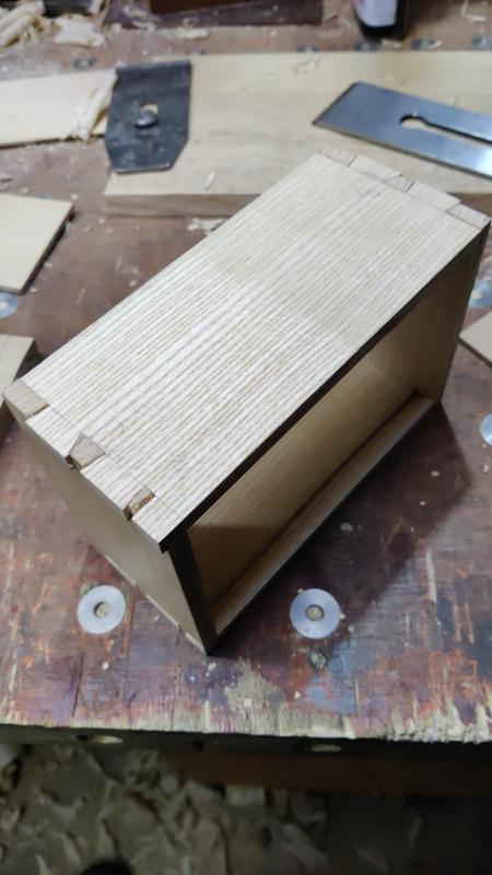

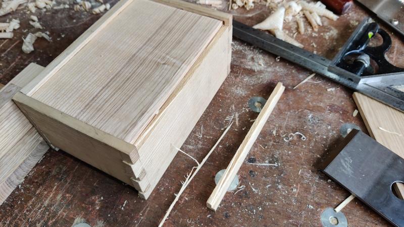

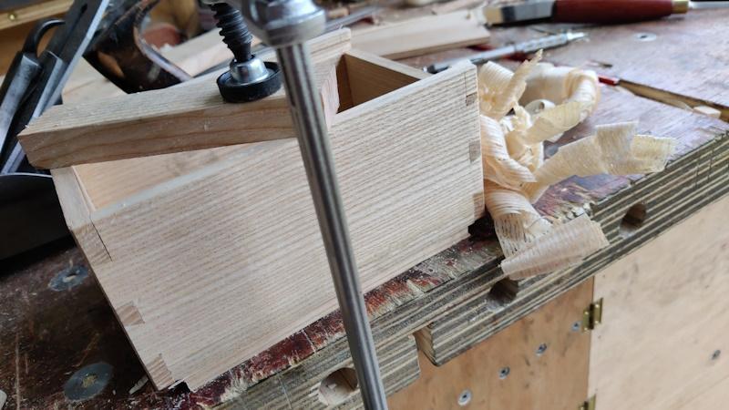

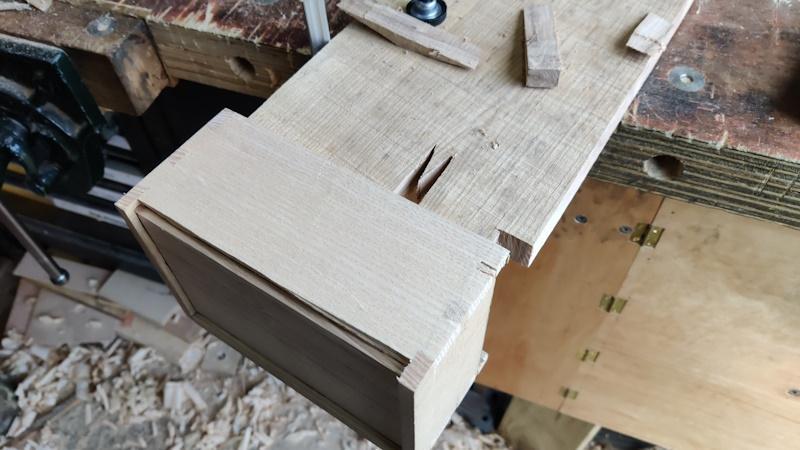

Once the glue had been left for enough time to dry, I planed the face on the side with the gap-fillers and the bit that had previously snapped off. Once that was done I got back to the lid. First of all, I trimmed it to width (having trimmed an offcut to width first to use as a reference):
I then planed the lid down to the thickness of the groove, leaving it at a rather tight fit:
A chamfer was applied to the underside (now making it a more comfortable fit) on three sides:
The lid was then slid into the box and the length marked:
I chopped it to length in the usual way (for once, the cross-cut saw was actually doing what it's good at!)
To clean up the end, I used a makeshift shooting board:
Amazingly, the plane was still managing to take some nice end-grain shavings despite all the abuse and lack of sharpening it has endured:

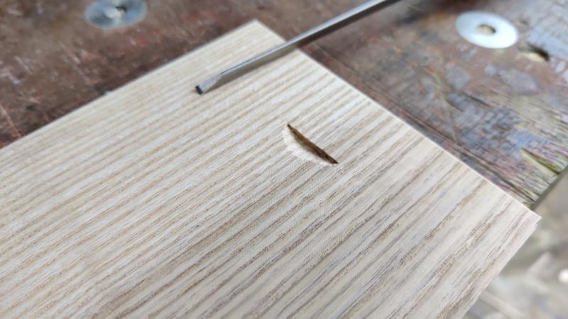

The last job was to chisel out a notch for use as a finger pull:

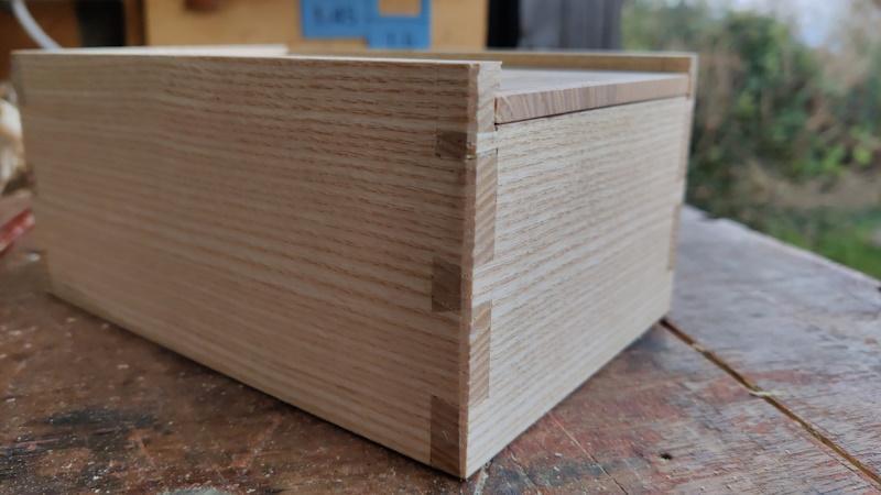

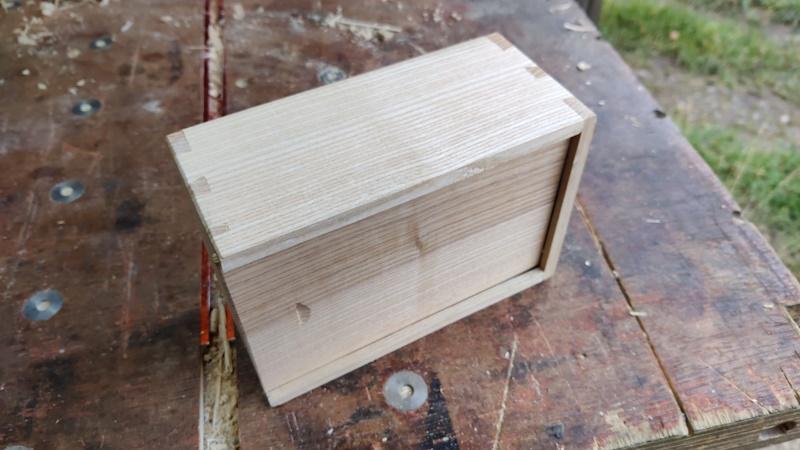

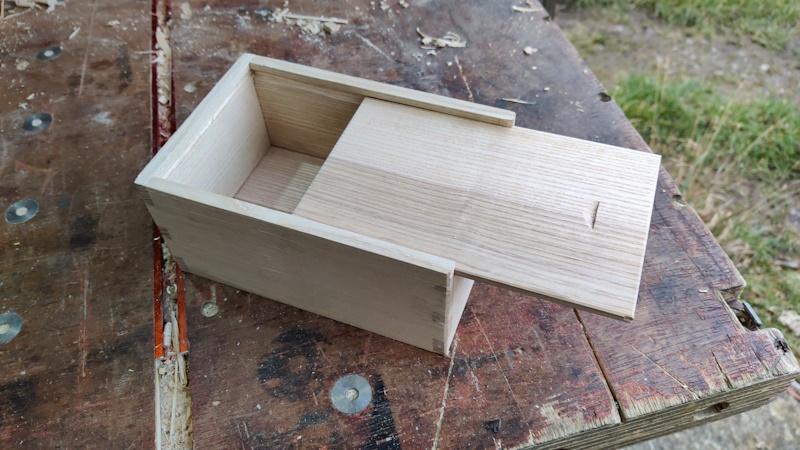

Finally, I can call it done:
I guess it could be argued that it's not finished without some, well, finish, but I've decided it's a perfectly serviceable and attractive box without any oil or whatever. That's partly to keep the tool count down, but mainly because I really can't be bothered to do any oiling!
This photo shows the filled in gaps and the re-glued snapped-off bit: neither are especially obvious in my opinion:
The final tool list consisted of the following 8 tools:
A Stanley 4½, a combination square, a 3 mm chisel, an F-clamp, a pencil, a (poorly chosen) cross-cut saw, some glue and a leather strop. No vice, no bench dogs, no sharpening stone, no cloths/rags and a distinct lack of any common sense shown by trying to do this challenge!
All that was left to do was a quick photo with the 8 tools I used to make the box:
Given how difficult some of the operations were, I really don't think I'd do it again, but I also think it was worthwhile in some ways as I learnt a few things and came to appreciate a few things more.
