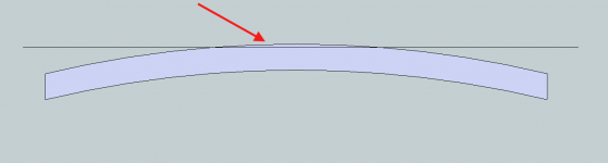

A trick that David Charlesworth recommends is to shave a bit off where arrowed and then leave it to settle for a few days. It seems counterintuitive but trust me, it does work !

Roger, I'll find the bendiest one and give that a try.

Here's me sorting the bowed lengths to try Roger's tip.
And here's the top of the bow with a bit shaved off like Roger said.
And if it doesn't work, roger, I'll be up the A1 like a butcher's dog!! :D

What is the theory behind that process?
I've no idea. Like Roger said, It seem counterintuitive. You'll have to ask him!

Can't recall..it was in his book. Book location currently unknown. Still in packing box 'N' where which one is 'N' is unknown !
